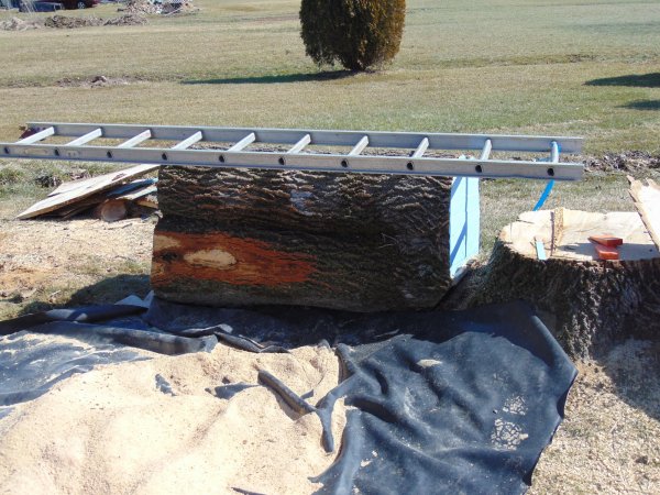

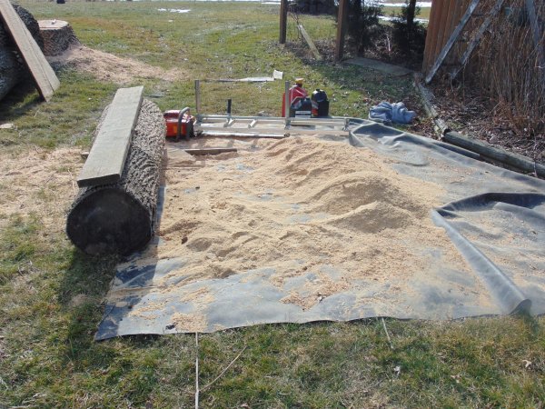

    Lotsa tips...
    A 2x6,8,10 can be used as a first cut guide, as can an old aluminum ladder.
    If you are milling somewhere you want grass to continue to grow, lay down something to catch the dust.
    Also you can see, get the ends of the wood sealed with something asap. Even old latex is better than nothing.
    If possible, get one end of the log raised up to assist in getting the mill to the other side of the log.

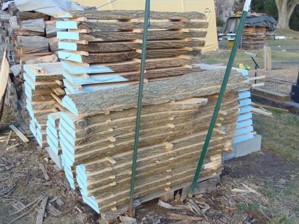

    Plan ahead for plank stickering. It takes a lot of stickers, and a lot of space. Stacks need top weighted, etc. Next thing you know, you'll have stacks everywhere.
    Stinny, M2theB, dingbat and 7 others like this.

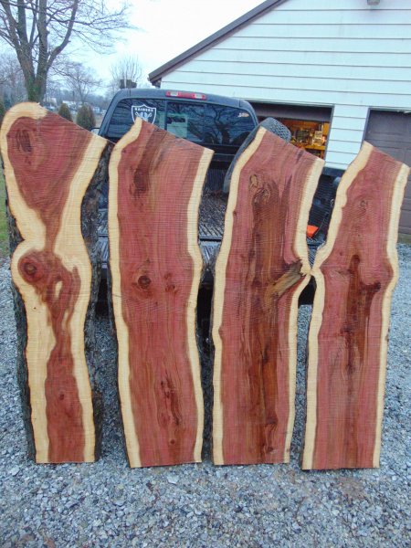

  6. The Wood Wolverine
    6,115
    35,356
    Gettysburg, Pa

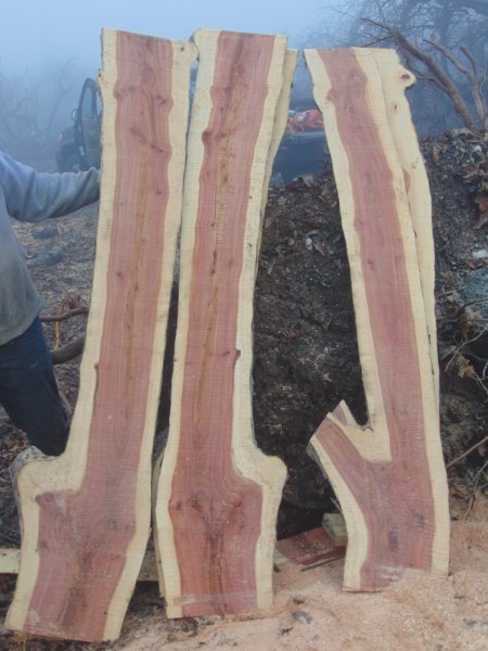

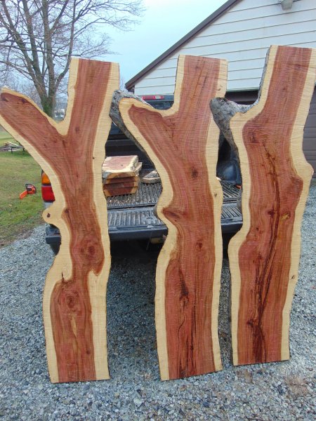

    Have fun with it. Some species yield really beautiful boards!
    Stinny, mike bayerl, M2theB and 6 others like this.

    also, those are some great looking boards there, will make something good I assume

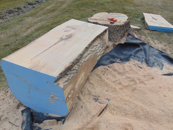

  17. Not_chip
    Not_chip
    Oct 23, 2019
    87
    272
    Tennessee
    [​IMG]my first time ever using a chainsaw mill
  18. The Wood Wolverine
    6,115
    35,356
    Gettysburg, Pa
    Nice, you're hooked now. Next thing you know there will be stickered stacks for wood all over the place.
