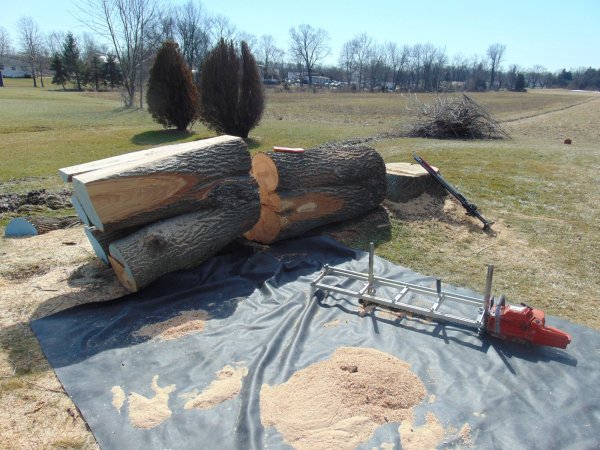

    Sure. Just screw the board down flat and run the mill down the top for your first cut. Again, be sure you don't hit the screws. Using a board longer than the log will make it easier to start and finish the cut by supporting the mill on both ends. After the first cut, the mill runs on the previous flat cut or you can continue using the board as a guide. I'll attach a few pics. We used an old ladder across sawhorses for our first cut on these logs but I've also used 2x10s.[​IMG][​IMG]

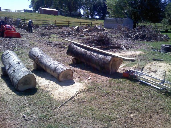

    Anytime. Also, use wedges in the cut so the bar doesn't get pinched. Plenty of great info in the milling forums. It's fairly easy to get started. Don't over-think it. You'll learn a lot as you go. Getting one end up and milling downhill helps too.[​IMG][​IMG]

    Poplar in the first 2 pics. We made benches and a picnic table for my buddy. I don't remember what the other log was. Could've been Poplar also. I slabbed it for another friend.[​IMG][​IMG][​IMG]

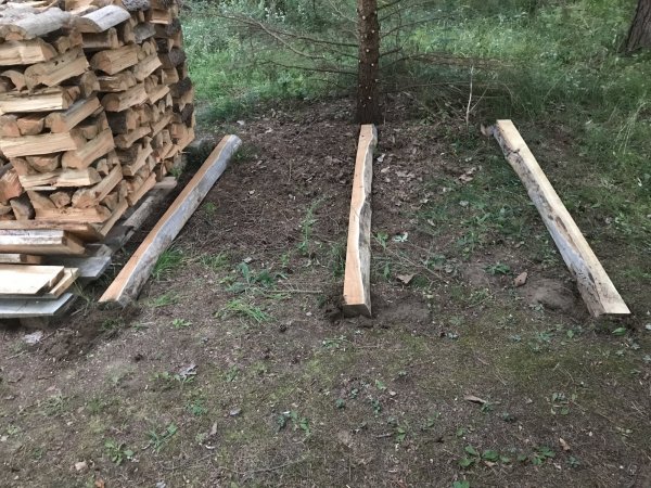

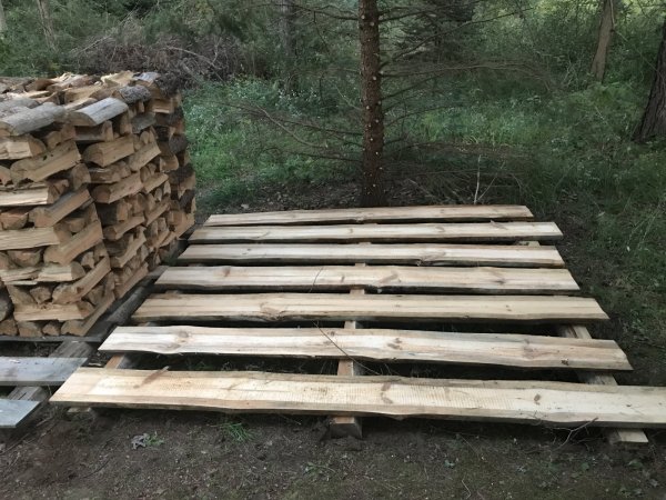

    It’s one of the most rot resistant hardwoods for ground contact in North America. It’s probably a superior choice even to EPA pressure treated they sell these days. I like to make it into 4x runners for my firewood pallets.
