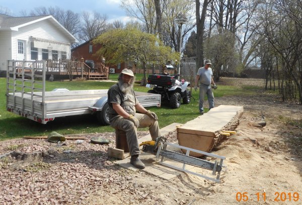

    I checked that book out from our local library and ended up buying one. It is a great place to start and then make the best of what you can get your hands on. The picture is me "sitting" and my brother milling a 28 inch white oak 2.5 inches think by 12 feet long. I was a LOT of work but I hope to end up with a really nice work bench sometime in the future. My McCulloch Pro Mac 700 was a bit short on power for the center of a log this size but I did get all the way to the end of the log on every cut.

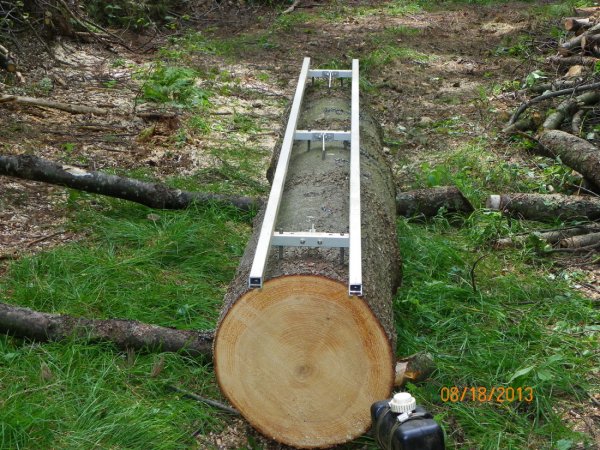

    It's been about four years since I milled anything but I also bought 15 feet of the EZ Rails. I usually run the 660 or the older 075 for milling with 36 inch mill. Since we bought the tractor (have the pallet forks) getting the logs off the ground will be easier which will make it better on my old frame.

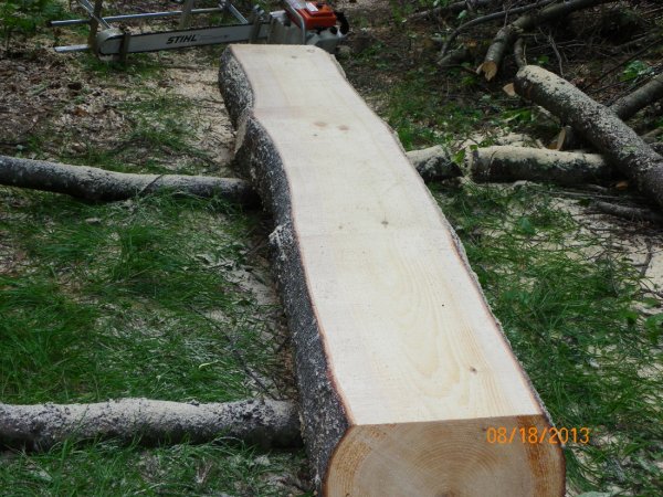

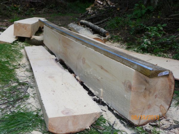

    Here's a few pics.
