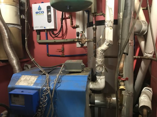

  17. don2222
    don2222
    Nov 10, 2013
    3,385
    4,731
    Salem NH
    Hello
    I could not decide either so I got
    1. Oil Boiler with Indirect SuperStor Tank for DHW
    2. On Demand Eco-Smart instant electric DHW
    I was using the on Demand Electric but when Covid hit I switched it to the oil because of the big price drop!
    If oil goes way up, then I will switch back to electric.
    Both systems use the indirect tank and with the pellet stove a couple of feet away warms the 45 degree water in the ground in the 40 gallon tank during the night up to 80 Degs!
    Note: if the air around a normal indirect tank is 80 Degs from the pellet stove then the water in the tank will rise up to 80 degrees too! No fancy dancy expensive hybrid is needed! LOL
    So I can have it the cheapest way. :) lol
