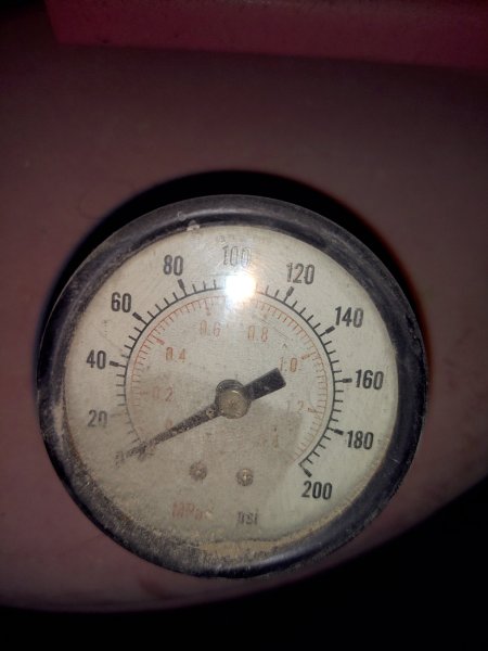

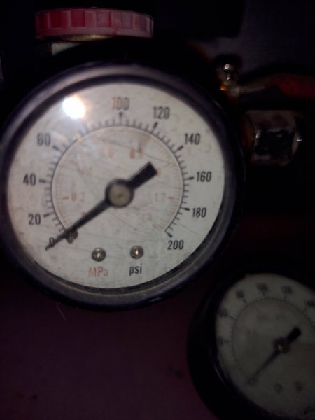

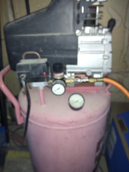

    What’s max PSI he wants if ya don’t know a pic of compressor would work
