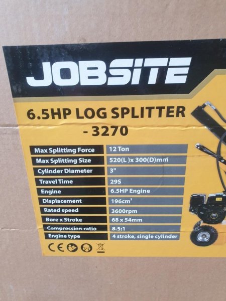

    We find ourselves in need of a new splitter. We're not attempting to match some of the miles of stacks displayed on here, but we are trying to get ahead of ourselves by 3 years at least and need to increase our current output.
    Does anyone have any experience of these splitters?
    Petrol Engine Vertical 12T Log Splitter
    Various brands seem to be attached to this model, some of which I've included in the thread title!
    Any advise/experience or recommendations would be very gratefully received!!!!

    On box is says 'travel time' and '29s.' If that means a cycle time of 29 seconds, it means forget it. Everything is sky high these days for a 'decent' splitter. The 25-ton Countyline one I have is now $1799. I am not aware of any 'decent' splitter (which I consider this one as the minimum in 'decency,' that you can get for less than, say, $1,200 and that's probably on sale. I do not see Tractor Supply discount their splitters much any more. Maybe $200 off. Where I live. Sad part is I paid $699 for it, on sale, (reg $899 at that time) and I think it was just five years ago.
    It depends on what you're splitting. If the budget is tight and you have easy splitting wood and no need to transport it, I'd consider an electric, they are far, far cheaper and should be more dependable versus one with a gasoline motor.
    EDIT: Oh, wait... you're in England. Not much help there.

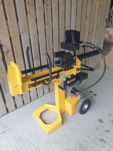

    I like the how the platform is designed to increase area when in the vertical position.

    If that's really a 6.5 HP engine then they have really undersized the pump to have a 29 second cycle time! Even a mediocre hyd. splitter normally has a cycle time of half that.
    Edit: I looked up the manual https://shop.cannontools.co.uk/images/shop.cannontools.co.uk/prd/1637136932CT3270 user manual.pdf
    Specs show 6.5 hp 196cc engine, 3" cylinder, and a woefully undersized 2.1 GPM pump. (single stage maybe...probably actually)
    A $125 pump swap would make this thing a rocket! https://ruggedmade.com/hydraulic-log-splitter-gear-pump-2-stage-11-gpm.html
    With the 3" cylinder (stated) and 1.5" rod (assumed) at 20.4" stroke (stated) this splitter would have a cycle time of 6.3 seconds with the 2 stage pump linked above on it!

    I'm with the majority here. I clicked on the link and saw a 29s cycle time. That is painfully slow and would frustrate me to the point of not using it. My 2 cents, keep looking!

    29 second cycle time? That's painfully slow. I'd pass, probably an electric model available in England that would be faster.
