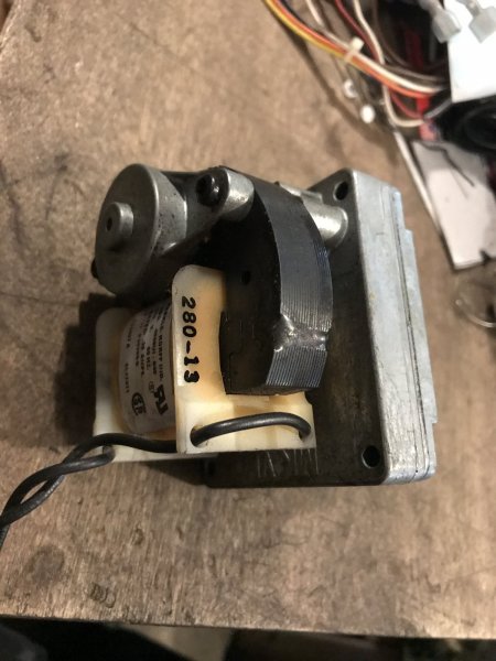

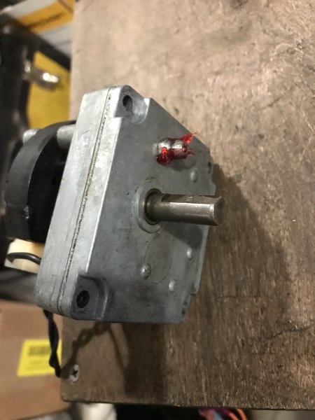

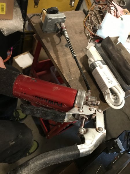

    The St Croix gearbox versa motor very similar to an auger motor but a more compact gearbox has always came from the factory with a high quality grease fitting. This used one I have hear was making quite a noise. Therefore I added the grease and it quieted right down! Amazing!
    See vids below. Should all gearbox motors have a zerk fitting??
    Part 1 - of 2 - Noise before adding grease
    Part 2 of 2 - Now see how quiet it is after adding grease - Amazing

    As long as the gearbox temps hold steady, it is a lot happier.
    But there is such a thing as too much grease, especially the 1800rpm and 3600rpm shafts with small bearing cavitites. Too much grease too fast can rapidly fail a bearing.
