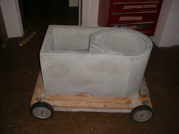

    I,ve operated a Jetstream with storage for 30+ years from what I understand its somewhat similar to the "rocket stove".
    Smokeless / This picture was taken with the boiler at full output!

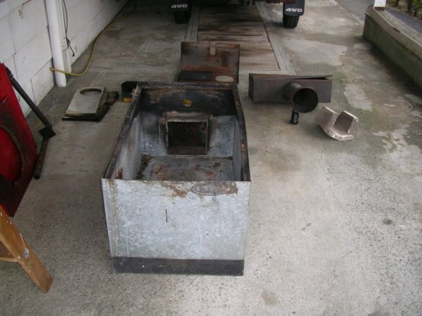

    I do need to build one. :DUsing #528 and it just won't die. I have unit #175 brand new waiting in the wings for its first fire! The third one on was its way to being rebuilt:thumbs: and I was told by my daughters :eek:that the third one had to go! o_O
    But to Build One :thumbs:- that would make for a interesting project.:drool::popcorn::rofl: :lol: I think that it would be better and easier to make the base out of high temperature brick instead of refractory!:zip:
    The sheet metal parts for# 3:(
    Even had a brand new refractory liner!:rolleyes:
