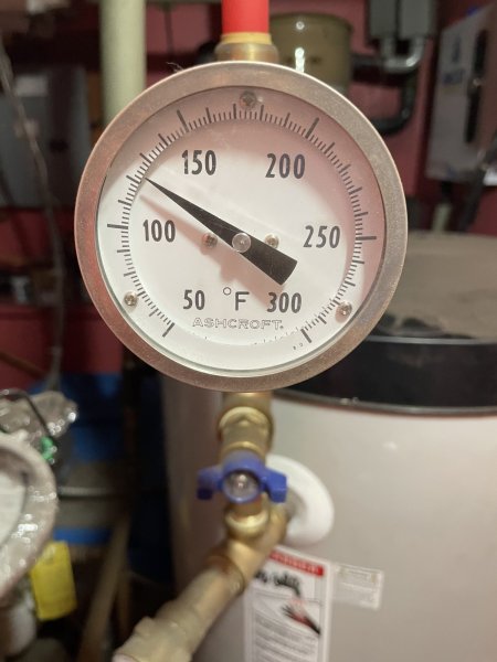

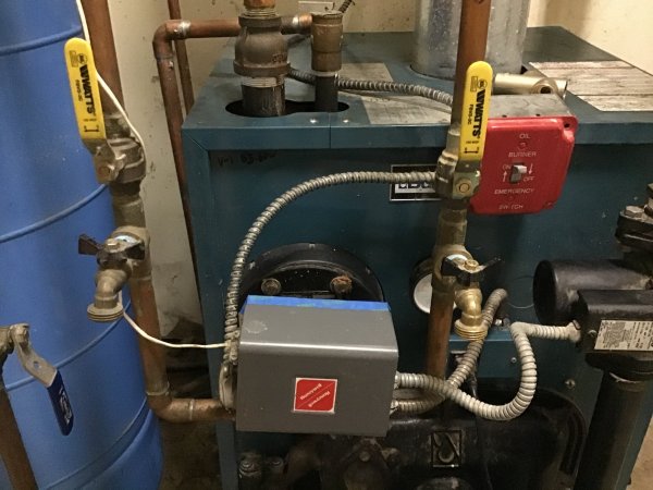

    What’s up, guys? So I have an tankless coil in my (Burnham) boiler that I get my hot water from, but I run out of water in about 5 minutes when I’m taking a shower. I had a friend over today and he said it seems like it’s probably a buildup in the coil due to hard water. He said it needs an acid rinse (Muriatic acid?)
    Has anyone ever done this on their own? Did you get good results?
    PS: my boiler already has the inlet and outlet faucets on each side of the coil, so it would be easy to isolate the coil.
    PA Mountain Man and eatonpcat like this.

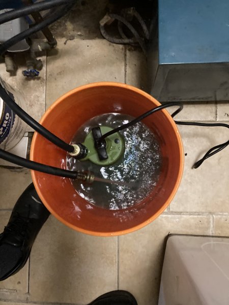

    6EECF453-9066-4D15-A036-BE85230C4C11.jpeg So, I did the hot water coil flush today. I used 2 gallons of distilled white vinegar. It started out slow, but pretty soon the vinegar was flowing smooth. I let it run for an hour and then switched the hose lines and ran the vinegar thru in reverse for a half hour. Afterwards, I took a shower and didn't run out of hot water. Success!
    ... I took a video, but I'm not sure how to upload that, so here's a photo.

    That's how I do the maintenance on my Rinnai tankless hot water heater. I used a filter on the hose to catch anything large but didn't see anything huge. I do it every 2 years. Did you see any debris in the bucket when you were done? I would imagine so. Nice job!
  10. PatrickNY
    PatrickNY
    Sep 4, 2021
    240
    1,763
    Putnam County, NY
    No, I didn't see any debris, but the vinegar was pretty black when I was done. I'm going to do it once/year from now on.
