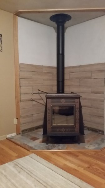

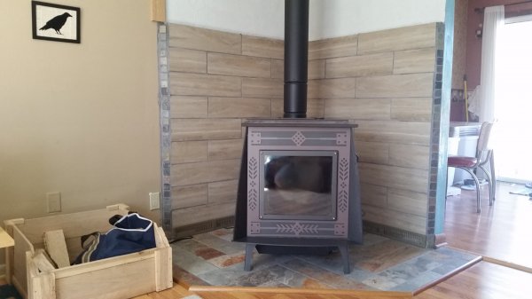

    I will try to make sure there is no dust tonight, I would guess its either burning creosote or dust. 1520186370010620952354.jpg 1520186414877489637557.jpg
    Maina, Backwoods Savage and Chaz like this.

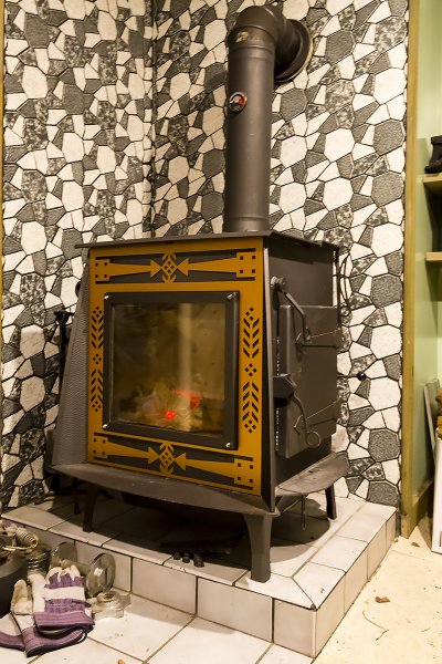

    NICE!! I have the exact stove except I have the bling that is a tad brighter (copper color?) and I vent from the top.
