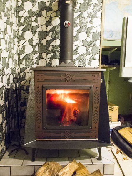

    I have not had any problem transitioning from high heat/secondary burning down to slow burn/cat heat. As soon as a drop down below 3.5ish the secondaries die out and the stove seems to go into long slow cat burn. I am very impressed with the length and consistency of the steady cat burn.. in this shoulder season it's been "fill it in the AM, get the heat up, then turn the draft down and let it run all day." About 11:00PM just do the same for the midnight to morning burn.
    I usually add a little wood after dinner but the stove keeps it's coals so long it doesn't seem to even need it until I do the evening load.
