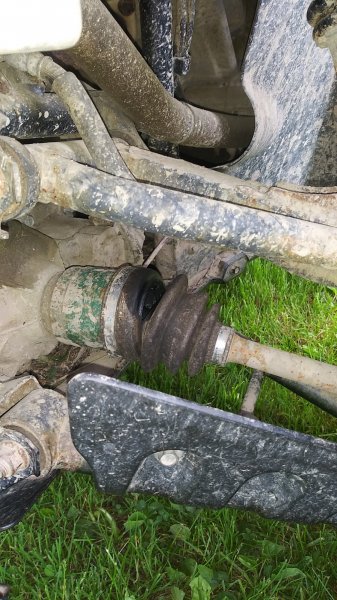

    It's an '08 Suzuki Kingquad 450AXI
    Looking closer.. there's this..
    So, I guess it's time for some maintenance that has obviously been neglected for far too long. I can't even remember the last time I serviced it.. but I know it's been many years.
    :emb::picard:
    So.. Gonna start with tie rods, new CV shafts, total fluid & filter change and spark plug.

    If that CV joint is not roached you can just have a new boot put on...and are the ball joints loose? If not, run 'em! It's not like on your truck where they need to be perfect...most ATV's joints aren't...or at least not for long.
    You might be surprised on the brake pads...4x4's have a lot of rolling resistance, so they tend to not wear out brakes like the sport models do...unless the parking brake sticks on...:whistle:

    What brenndatomu said but don’t forget to repack the cv joint before the new boot is installed

    Well, it's not making any complaints.. no noise, and I think it is relatively recent.
    But.. needs to be taken care of either way.
