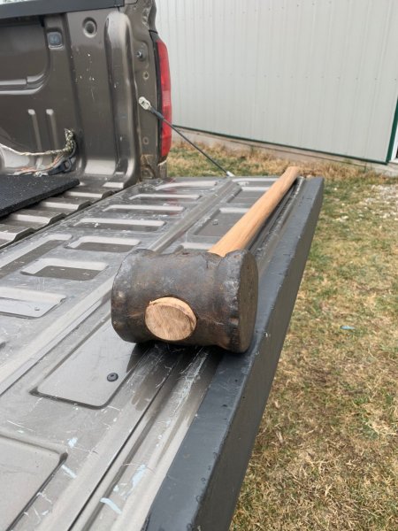

    Got it done, cleaned up and a new handle.

    Awesome! That bad boy has some character!

    Wow that is quite a maul. You better be in good shape to swing that baby.

    I can see why you'd be excited, that is one DANDY looking maul!! And, the fact it was your dad's really makes it special!

    Yep, one needs to be in fair shape. Once you start pounding a post with it, there's a technique where the hammer will bounce off of the post and you just keep it going in a circle, but you don't want to miss the post with it. :)

    Why is that a maul and not a sledgehammer?

    That's because it's made for driving wood fence post into the ground, that have been sharpened like sort of like a pencil on the end that goes into the ground. It's probably made out of cast iron or cast steel of some kind but is not made to strike anything that is made out of metal. If you were to strike metal with this maul, there's a high risk the head would break or chip off badly. Lots of old mauls like this have been ruined when someone decided to use them as a sledge hammer and struck a steel object with them.
    The old timers actually made similar mauls for driving fence post and other chores out of very dense wood some times.
    Also the shape of it is big and flat on the head so as to mate up with the top of a wooden fence post and not damage the top of the fence post too badly when driving it. A sledge hammer is more rounded on the edges, and with it's different shaped head would inflict too much damage to the top of the wooded post.

    That's a cool looking piece.
    Looks like a sledgehammer from an episode of the Flintstones
