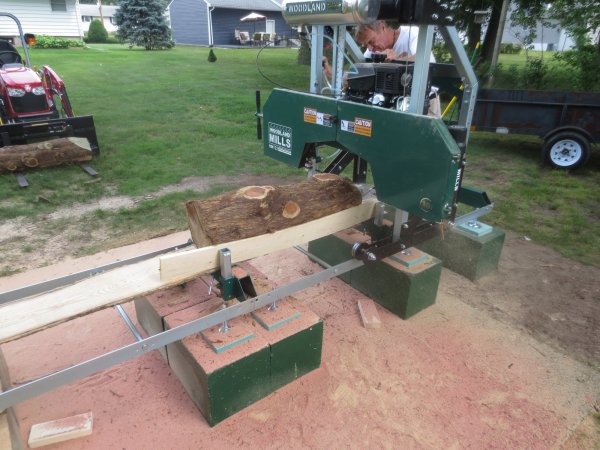

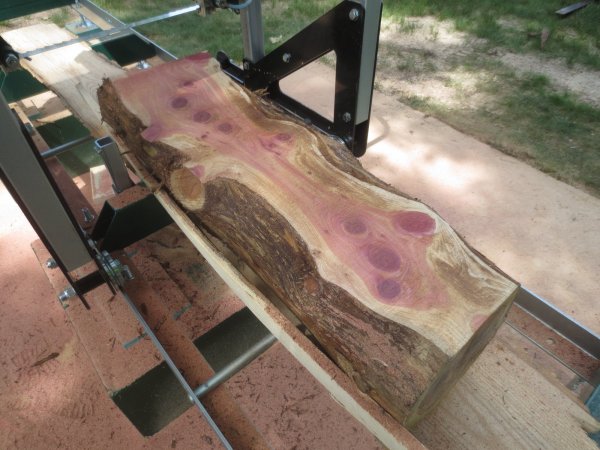

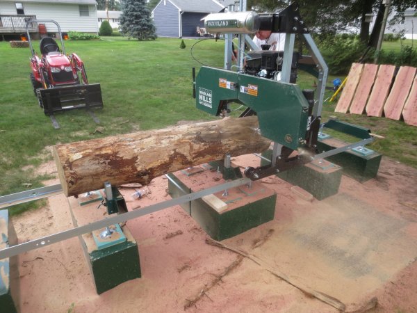

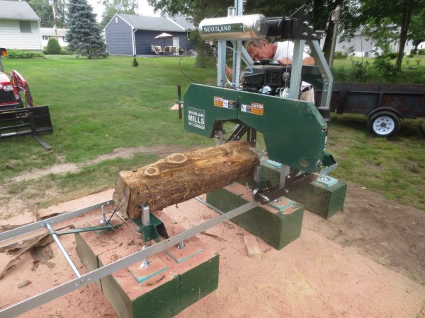

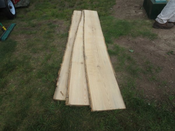

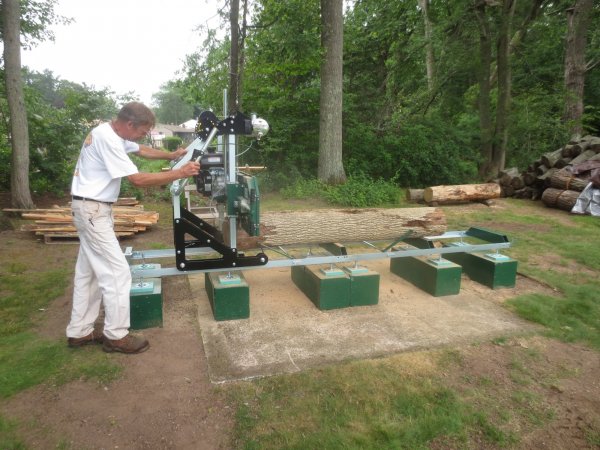

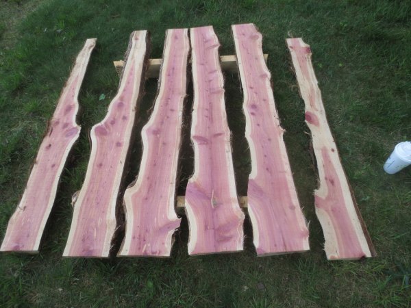

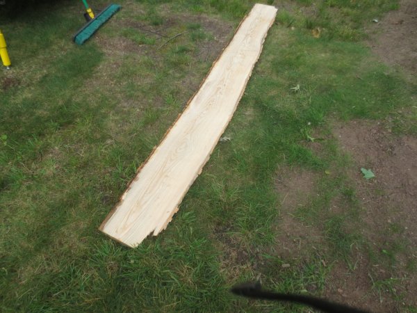

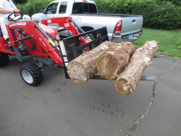

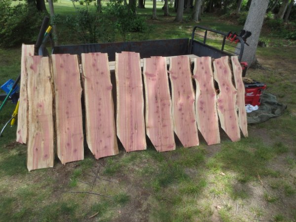

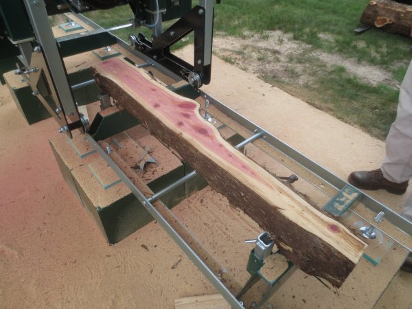

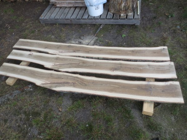

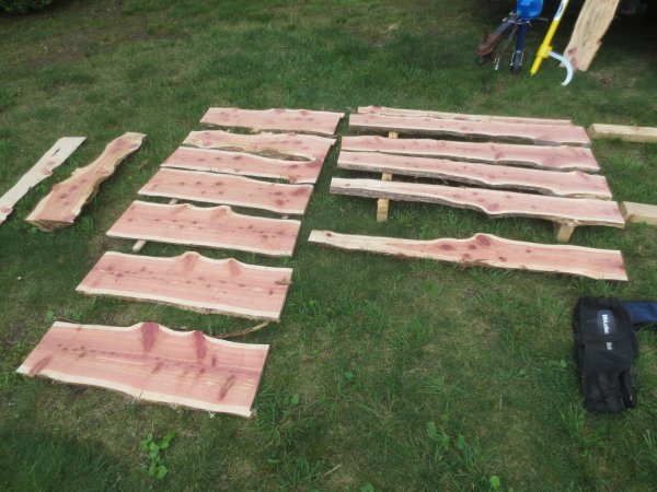

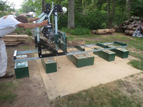

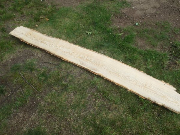

    Here's the pics Ash up first. IMG_5272.JPG IMG_5273.JPG IMG_5274.JPG IMG_5275.JPG Then some red cedar (juniper) i had saved from a couple years ago. Dump scrounge. I found myself admiring the cedar more so than watching him mill. I have a new wood to love (no snide comments FHC, please) IMG_5276.JPG IMG_5277.JPG IMG_5278.JPG IMG_5279.JPG IMG_5280.JPG IMG_5281.JPG IMG_5283.JPG IMG_5284.JPG IMG_5285.JPG

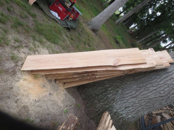

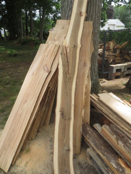

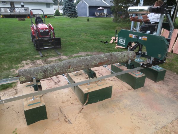

    All in all a fun day milling. I really enjoyed watching logs come to life. The four hours passed in a blink.
    I have use for the hemlock already and the cedar will become some outdoor furniture. More logs to come of course.

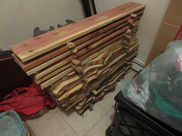

    Stored the cedar in an extra room downstairs IMG_5292.JPG Smells better than musty room
    it will collect sawdust! :whistle: Cant believe how much it made yesterday!

    Yeah, the csm is slow as dirt. That’s one of its biggest drawbacks.
    Great planks! Didn’t look like you sealed the ends with anything Brad. Might wanna slap something on there to help with splits/checks/cracks.

    I dont have anything on hand. Those logs are maybe two years old. I jabbed them with the MM this morning and 17%.
    Question for you...what is the ideal MC before using for a project. I dont think red cedar is that prone to warping.

    I’m not a pro.. I’d be looking for about 10% or less.

    Do you want to use indoors or outdoors? For outdoor projects, ideally you would stack and sticker it until it stops losing moisture (equilibrium moisture content, EMC). This depends on your local climate. I've read that around here wood will equilibrate around 12%, less in the desert, more in rainforest. Here's the USDA document where you can look up your local climate and EMC for air dried lumber https://www.esf.edu/wus/documents/EMCofWoodFPL268.pdf. You can stop there if using the wood outdoors. If you want to use it indoors, you need to get it closer to 8%. To do that, you need to run it through a kiln, or if you have the room and time, you can bring the airdried wood into your house and let it equilabrate again in there. Ideally, you should run all wood through a kiln to sterilize it, killing the insects, fungi and bacteria.

    Probably used mostly for outdoor furniture. I dont have a kiln so its indoor dried til ready for use. Wehave a rasied ranch so its cooler on the lower level. I only have the cedar down there for now. Not much room. The hemlock will be ripped with circular/table saw and used for strapping on a project. That is stickered outdoors out of the sun. I can live with some cupping if it does.

    Sounds good. If you want to store or dry lumber in your basement get a cheap temp/humidity meter and make sure the humidity is not too high. You can always run a dehumidifier if you need to or want to accelerate drying.
