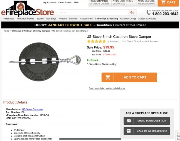

    Not familiar, but can you add a damper to the stove pipe above the stove?

    Something like this should help control the air flow.. just need to ensure the one inside of the top of the stove is left open.

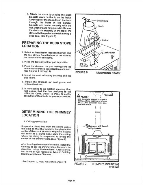

    I looked in my manual this morning, and did not find an exploded parts diagram. However, several spots mentioned the combined stack/damper, so I'm guessing that maybe the damper is held in with the bolts that hold the stack on.
    I found this in my manual:
    https://s3.amazonaws.com/gs-geo-images/ee311d79-c161-4250-9aaf-7b9b8cdc5c87_l.jpg
    And, yes, without the damper, the stove will burn VERY hot, with most of the heat going straight up the stack, even with the drafts completely closed. 700 degrees is REALLY hot! If you burn it as a fireplace(which they say you can do), you have to be very careful of the wood load, as it's easy to overfire it.
