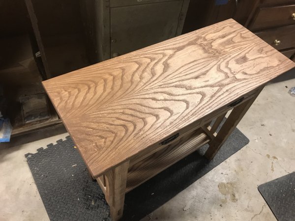

    Someone here made an awesome entry way bench/ coat rack/storage, was it you Pallet Pete ?
    Camber, blacksmith, milleo and 4 others like this.
  14. Chaz
    Chaz
    Jan 27, 2018
    8,549
    60,216
    Southwestern NY
    the size of that table is just amazing to me.. I have a hard time imagining the cookie monster tree that that cookie came from. :cool:
    Not a fan of the chairs, but the table and bench look awesome. :thumbs:

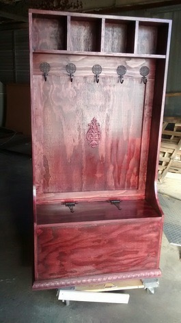

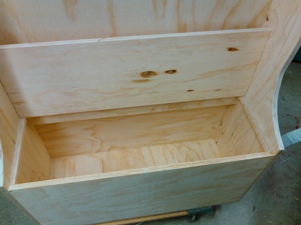

  15. Pallet Pete
    Pallet Pete Moderator
    13,451
    53,867
    Ovid
    I made a hall tree a few years ago for the wife.
    I appolagize I’ll have to find the rest of pictures these aren’t vary good. It’s not made of boards though it’s plywood stained and polyurethaned.
    By wood working standards it’s done wrong with the grain going opposite each other but I liked it so why not...
    690B0D43-2D39-49D1-9FDF-94E50E511500.jpeg ADFEBCD7-33C7-4751-A45D-8482777C2C47.jpeg

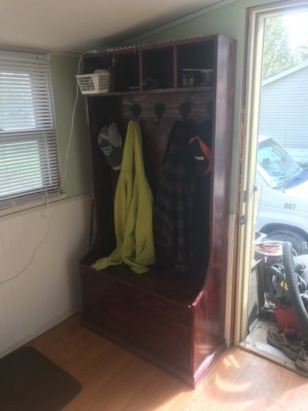

  16. Pallet Pete
    13,451
    53,867
    Ovid
    Setting in place in the mud room.

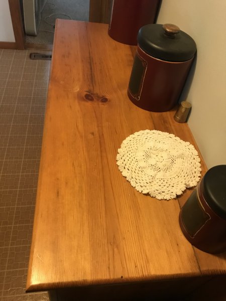

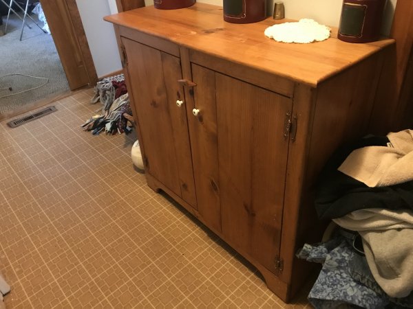

  17. Shawn Curry
    Shawn Curry
    Jul 31, 2014
    3,755
    22,692
    Western NY
    My grandfather liked to build Early-American style furniture from pine. Most of he wood he used looked to be some nice old growth stuff - very narrow growth rings and nice wide boards.
    I have a couple of his pieces - this cabinet is in our laundry room.
    AC243CB7-B331-42AF-BECE-2E4C8C745753.jpeg B29CA268-47F2-4857-B050-FAFE4F132901.jpeg
    If I had some old growth pine, that’s probably the style I’d build. It’s also traditional for Shaker pieces.
    If you’re looking for a sawyer, wood-mizer has a database on their website you can search for local guys to hire in your area. You’re going to need to find a biggun for that size log.
    Depending on your tastes, the next problem you’ll run into is surface planing those nice wide boards. Of course, back in the day they did it all with hand planes and that’s still an option. But what I usually do is rip the boards down until they’re narrow enough to at least get them thru my lunchbox planer, and then glue them back together. You’ll want to leave the boards a bit longer than your finished length as the match will usually “slip” a bit as you plane the boards.
    Camber, blacksmith, Chvymn99 and 3 others like this.
