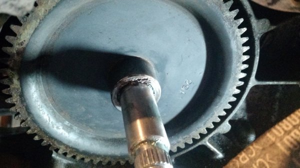

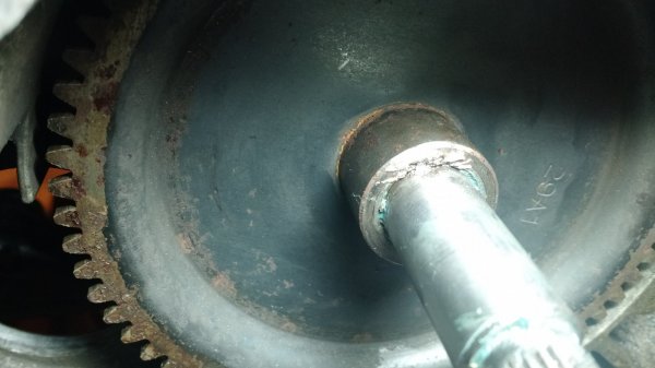

  17. cnice_37
    cnice_37
    3,205
    14,198
    Yeah, so it would look to be. I can't get the flywheel off and not sure how.
    I had a brilliant idea to chisel the sheared key off on the shaft thinking it was not allowing the flywheel to pull off cleanly. No go, not sure if rust plus some remaining metal resistance, very little access to hit it with a BFH... I am at a loss unless I weld something to it to pull from front.
    Any ideas?
    94BULLITT likes this.
  18. Horkn
    28,552
    161,551
    You may have to weld a couple of nuts to it to pull it. Then grind off the nuts after you pull it off.
    It's kind of a common issue on many makes of small motors like this.

    I found 2 types of pullers for it but I'm not sure either type will work.
    I don't see any holes in the flywheel so this one won't work.
    SUZUKI LT80 KAWASAKI KFX80 LT KFX ENGINE MAGNETO FLYWHEEL PULLER 87-06 | eBay
    I don't see any threads on the center of the flywheel either.
    Can you very carefully pry on it while tapping on it? I'm not sure that welding to a flywheel is a good idea.
    What I mostly do on a chainsaw is thread the nut on the end of the crank and hold the saw by the flywheel. I put a socket on the nut and tap on it. I'm not sure if you could do something similar.
    cnice_37 likes this.
  20. Horkn
    28,552
    161,551
    The other option is drilling and tapping threads into the flywheel.
    Welding onto a flywheel to remove a stuck one is pretty common fix. Then grind what you welded off after you pull it.
    Screwloose and cnice_37 like this.
