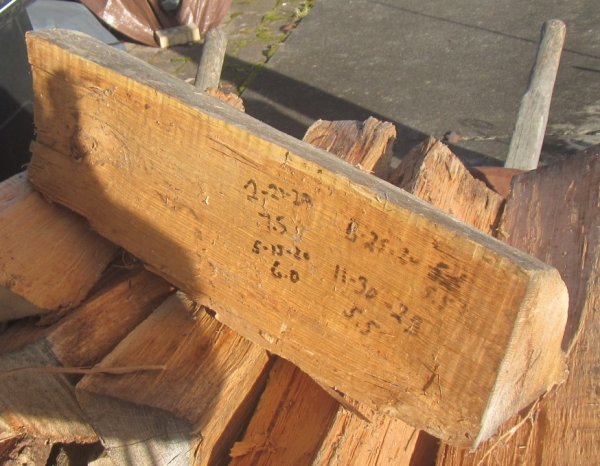

    Moved a rank of firewood today to a shed beside the driveway for easy access when the snow flies, as it was previously stacked at a place that got good sun and air movement, but would be hard to wheelbarrow to the porch in snow without considerable work. Standing dead Red oak cut in winter 2020. First picture shows weight when first CSS, and subsequent weights. Not easy to read so:
    2-27-20 7.5 lbs
    5-15-20 6.0 lbs
    8-25-20 5.5 lbs
    11-30-23 5.5 lbs
    Apparently it was ready to burn in the winter of 2020 as it did not lose any more weight since. Interesting but not surprising.

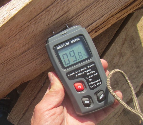

    I used to just track wood moisture that way, with weighing, but I just split and checked it with a moisture meter I recently purchased (which you FHC guys shamed me into getting;)), and it read 9.8%.

    Being dead standing I'm not surprised at all that it reached peak dryness in 6 months. Oak is funny like that. Sometimes 6 months is enough, sometimes 3 years isn't enough. Each batch CSS'd needs to be considered individually, and the chart that says 3 years needs to be taken as a general guideline and not gospel.

    That reminds me I’ve got to split that pile of mixed lauan and keruing I’ve got out back.
