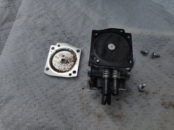

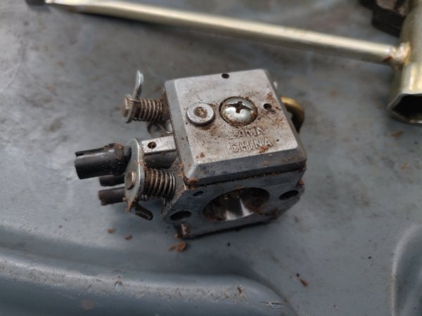

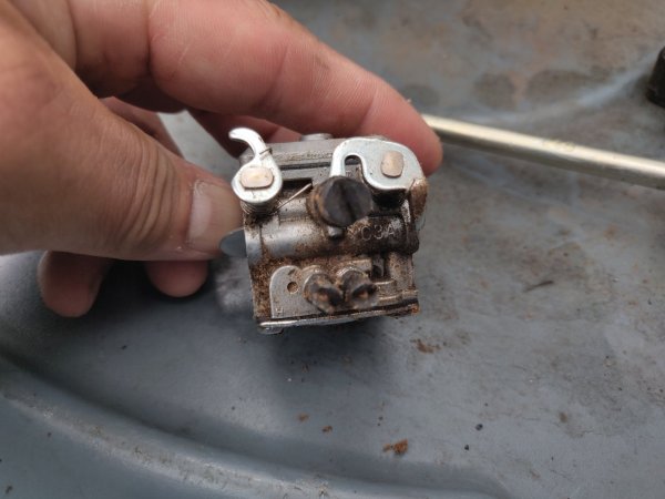

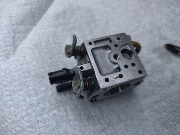

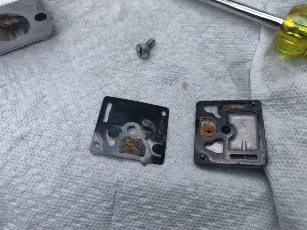

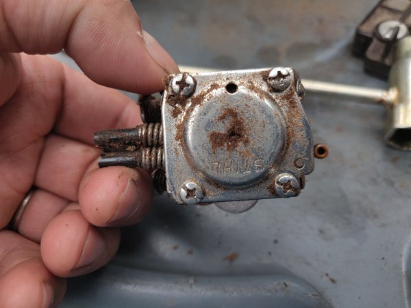

    Could be a split fuel line. A clogged fuel filter. A fuel filter that fell off and then the line got clogged. A dirty screen on the carb. A dirty needle pin inside of the carb. Could be a dried out old black rubber diaphragm inside the carb. They should be soft and flexible, not stiff and coated with like a varnish.
    I'd check the fuel line and filter first. Open the tank and take a peek inside.
    Here's some before and after pics of the 034S carb when I got it. Very dirty.
    2021-07-18 15.05.48.jpg 2021-07-18 15.05.55.jpg 2021-07-18 15.06.10.jpg 2021-07-18 15.09.12.jpg 2021-07-18 15.09.15.jpg 2021-07-18 15.14.11.jpg
