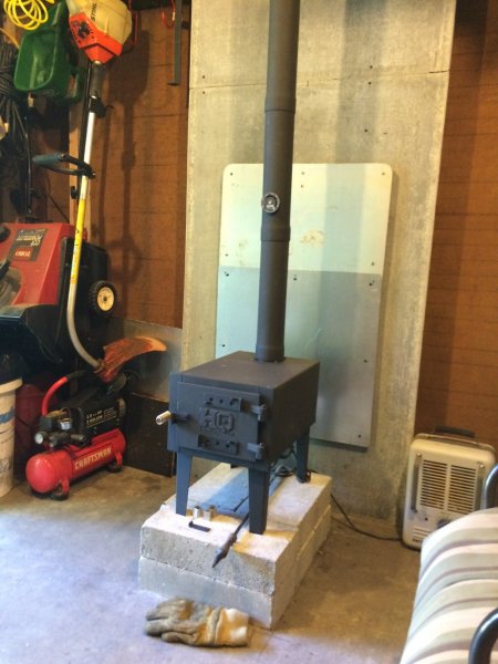

    Well, not EPA certified, or UL approved, but safe. My new wood stove in my wood shed.

    Looks like it has no seal on the door?

    Ok, try answer all the questions. The Chief inspector hates to admit it but hey, I'm retired right. :thumbs:

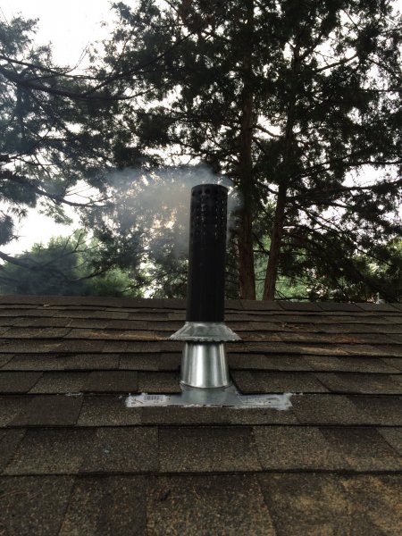

    Since the stove is not EPA certified, or even UL approved it would have to meet NFPA 211. That would require it to be 36 in from combustibles. My little wood shed is not big enough for that:hair: so I built a heat shield with Wonder Board. The through the roof was the biggest problem. The stove is for outfitter tents. Here is the link. HQ ISSUE Outdoor Wood Stove - 648081, Stoves at Sportsman's Guide
    The stove pipe is heavy steel all the way through the roof, so I had MacGyver a solution to get through the roof.
    The little rascal burns and draws like a champ, even on 85 degree test day.
    My wood shed is only 160 sq ft but it serves as yard shed, wood shed and man cave. I spend s lot of time out there. Buddy is always with me and he couldn't care less about a bed. Just lays down anywhere out of my way on the floor. :thumbs: We like our heat. Besides, it's just going to be plain fun. The little fir box measures 12x8x17. So my wood which I cut 16 fits just fine.
    I will never leave it unattended, so I think my MacGyver installation will be just fine. Don't know what the chief inspector is going to say :rofl: :lol:

    If the Durock starts gettin uncomfortably warm and you get concerned, you could always attach an 18 ga. skin (painted or plain), stood off from the Durock about an inch.... Then you'd pick up a little radiant reflection as well.

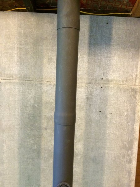

    Eric. That's what I thought too. Thanks. Think I'll do that. Here is the chimney. image.jpeg

    That's a cool looking pipe. Did you drill those holes?
  16. tfdchief
    tfdchief
    Jan 30, 2014
    1,233
    7,631
    Tuscola, IL
    Nope. Came that way. I did make The cap for it. 5 sections, each 16 in.

    Good idea Eric. Worked like a charm!
    Durarock is cool to touch behind the heat shield. Chief

  18. Eric VW
    23,600
    133,375
    Awesome addition to your sweet set up Chief! Keeps on lookin better in every pic!:thumbs:
