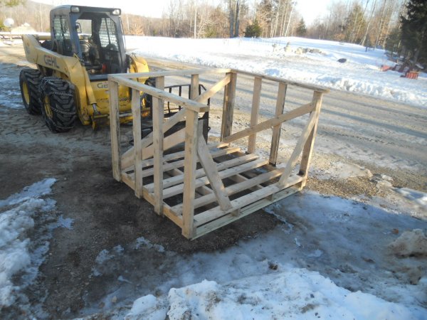

    I'm experimenting with these (2) wood crates for permanent use off the splitter & drying, then to the house & repeat. The only problem is I'll need a LOT of them to be fully converted and eliminate stacking & then loading into the "boxe's" I use now. That's r/s hemlock and still near $80 in materials :eek: It will be a lot easier to cover (and uncover in the snow), and I should be able to stack 2 high. It's just a little expensive IMHO. I'll see how these work out and maybe If I slowly transition into these it'll be like payments:whistle:
    They're about 100 cu/ft each, about all I can reasonably move at once. DSCN8499.JPG DSCN8501.JPG
    I'll get a pic when loaded.

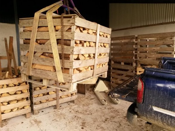

    woodcrate 01.jpg woodcrate 02.jpg woodcrate 03.jpg We use what are called "tree crates". Small, potted trees are are imported in them. The nurseries sell them off as they're not worth shipping back. We pay €12.50 (~$13.50 at the moment) for them. They're not as sturdy as yours but generally last a few years if kept under cover. According to the FHC calculator, they hold just over 0.25 cord. I'm not sure if there is a US equivelent but if you search for "pallet boxes", something might turn up.[​IMG] [​IMG] [​IMG]

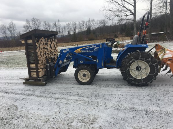

    IMG_1733.JPG IMG_4839.JPG I make mine out of used lumber I get for free

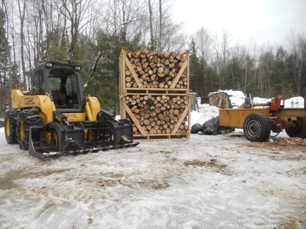

    I got a late start on filling the 1st one this afternoon, I placed it right behind me standing at the splitter. As I took each split off the splitter, turned around and put it in the crate, all the time thinking that I won't have to touch that piece for a year of so, and that will be to burn it, the cost of building it started to make sense.
    I made a sawbuck out of this material at least 6 years ago, it's been outside ever since and shows no sign of giving up yet. Once filled, I'll be putting old roof metal on top of these for storage and that will keep the bulk of rain off of it making a 10+ year use realistic making the cost a lot more reasonable.
    (do y'all hear me talking myself into this "system"?):D

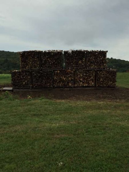

    001 (2).JPG 001_28429.jpg 003 (2).JPG I use free pallets as the base, R/S pine for the uprights and tops, (or salvaged wood when I can get it), free aircraft cable for connecting the tops (company threw out an entire roll). Holds approx. 56 cubic feet which is about my max for the tractor. I made jigs to put everything together.

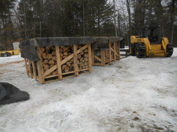

    Well I think I'll be building these for all future firewood made. The machine moves them with no trouble and it should be a big time saver in several step's. I like to top cover and I really have to pile a lot of crap on both metal and rubber roofing to keep the wind from taking it off. I threw some rubber roofing on them today (all my metal was froze into the snow & ice) and I'll be able to throw a few screws through the rubber into the firewood at the corners to keep it on.
    Then there's uncovering it, usually with at least a foot of snow & ice on it, oh and I like to stack my double row up to about 6' tall, so it's a real pita to uncover & load into my box's I use now to carry to the house. "Pulling" off a 6' tall pile makes for a long taper and is a pain to deal with during the whole process (building, covering, uncovering, loading & re-covering. Since I haven't figured out how to get any younger, these box's will be more appreciated every year.:thumbs: DSCN8507.JPG DSCN8513.JPG
    You can see my stacks in the upper pic and building the inner row with my mechanized system is also hard with only about 9' between the rows, and that slight slope turns to ice, in fact I busted my a$$ today just walking through at lunch time, with the box's I can split & cut out in an open area or anywhere on the property for that matter. I'll see how it go's but so far I think it's worth it.
