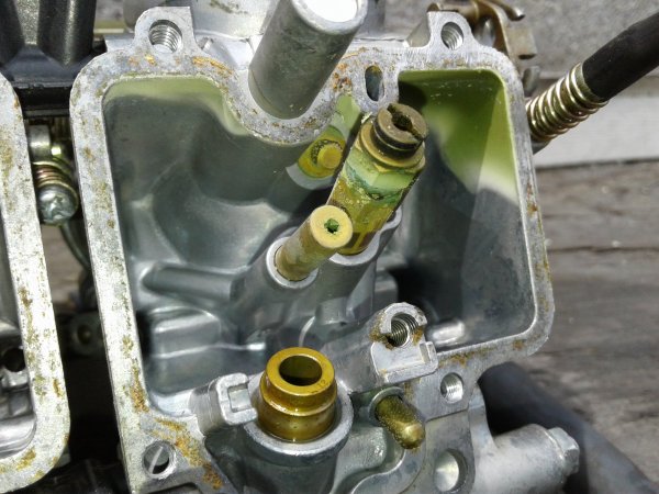

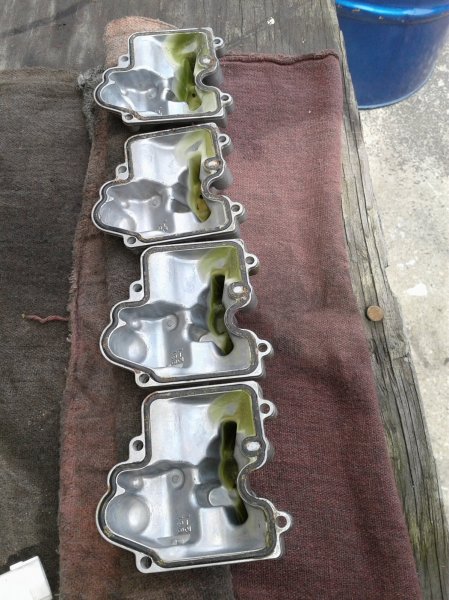

    I work on motorcycles as my daily. I've seen some nasty stuff.
    If you plan to leave it sit for extended periods and use fuel with eth, use caution. Every fall we run treatment through every bike. I run my saws regularly to prevent any issues. I know, erl has additives, but I've seen some nasty saw carbs too.
    Moral of the story, when in doubt, buy yourself a can of trufuel and worry no more.
    RCBS, Nixon, Ronaldo and 4 others like this.

    What's interesting is the water settles on the bottom.
    The green is again probably a reaction of the alcohol presumably settling at the top.

    And the very bottom of my bowl was where I got the green.
    Bow my boats, they always get E free fuel but the carbs still plug up but it's from drying out and the oil and the gas leaving nasty gunk in there but really it's a thick like tar in the main jet in the bottom from the fuel evaporating. There none of the crystals though.

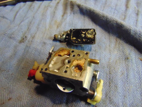

    If you've been working on bikes any amount of time I'm sure you've seen way worse than those too...that chainsaw carb is pretty crusty. I cleaned the carbs off my buddys Polaris sled a few years back, he said he always used Seafoam in it...dunno what happened because it was all kinds of nasty...I don't use Seafoam, didn't before, definitely don't after that.
    Its kinda weird, it seems some guys do everything right and still have trouble, and others don't do anything special and seem to get away with it...although I'm sure it bites 'em in the azz sooner or later...

    I've never seen a carb as krusty as that saw one I pictured. It came off a 55 my son was given. In fact I just had a scooter carb last week I had to pull twice. The pilot jet was clogged up with a very hard substance(for lack of a better term). Then another microscopic piece gets sucked in... Leaving stuff sit is the worst thing you can do with the ethanol used today. I've seen plenty of nasty stuff as a result. I personally have never had one problem with it. My tiller and seasonal 4 strokes get this.
