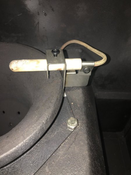

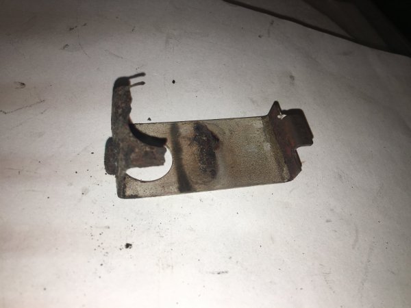

    The bottom part of the old clip rusted out but the new clip holds the wire in so it will not slip back with a new section!!
    It works well! Now the stove won't screw up because the wire pulled back out of the tip!
    Here it is on my CB1200 with 2 upgraded Stainless Steel 1/4"x 20. 3/4" long upgraded bolts to hold the fire pot in and a new White high temp fire pot gasket!
    Anyone else do this?
