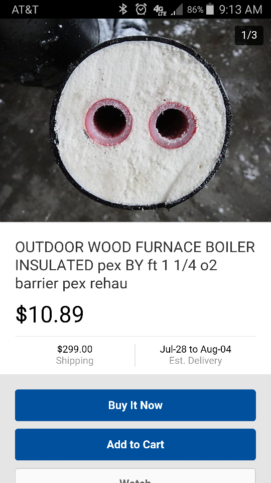

    Looking for. 80 ft of 1 1/4 dual pex insulated pipe.

    What's ur budget? I would look Into the thermopex. There's multiple different manufacturers, the more money you pay for your pipe will save you money in the long run on wood consumption.

    Would like to spend under 10.00 a foot

    10$/ft will get u above average pipe

    Just ordered this stuff for the house heat exchanger
