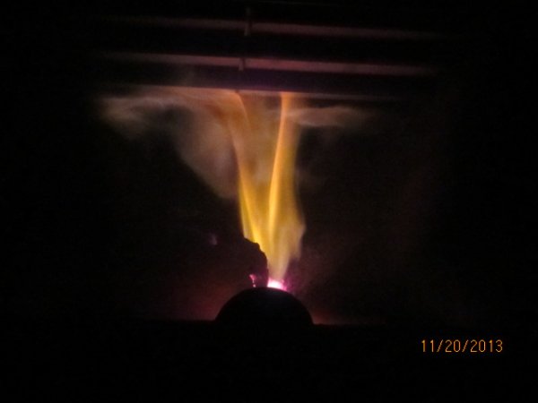

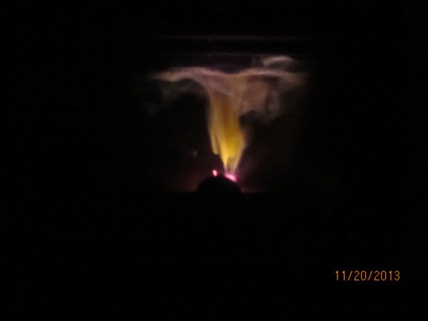

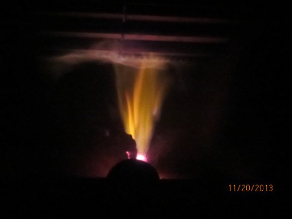

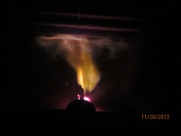

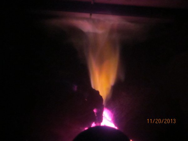

    This stove is sweet sweet sweet.
    Amazing secondaries with rather small pieces of nice dry oak.
    Granted, it's not so cold out , but I'm running this as low as it will go and still have secondaries.
    Some smoke earlier when I was burning just 2x4s, and not much of a secondary show, but with nice dry oak this is really really nice.
    I think this stove is gonna work real well for a unfinished basement install.

    Yeah, the glass is smoked up already, not too bad considering I'm trying to keep the temps down initially and see how low it will go.

    It has been a bit too warm to do much more than see how low it can go.
    Cold stove during the day.
    Glass is cleaning up so maybe some of the initial soot on the glass was the fire brick.
    One night I got a good bed of coals going by 8PM and tossed a couple medium size chunks of nice oak in and there were some coals at 7AM - but didn't try to get a fire going with them as it was supposed to be 60 by noon.
    Wasn't windy and wasn't terribly cold -twenty something for a evening low
    Paid $1000 with legs and no blower.
