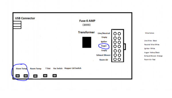

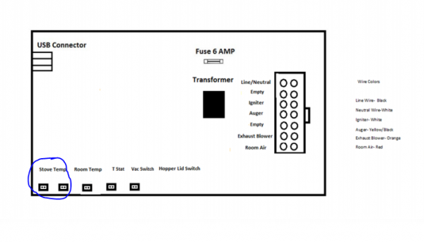

    Looking into this stove, it would be great for someone to chime in on it. What is the actual model? IHP shows it being a 55-TRPCB but I dont see that model on the website? If you look at the manual find the wiring diagram of the correct stove, it might help figure this out.

    Maybe not, but looking at this tells me something. There is a stove temp connector which in my mind (and if I am correct on the Harman operation) correlates to how the Harman works where it uses the ESP in the exhaust to tell the logic board the temperature of the stove and make adjustments from that. This tells me that there is a sensor somewhere (exhaust maybe?) to tell the unit how the stove is running. The exhaust blower speed can be adjusted to alter air flow. There is also a room temp connector which also should be for a room temp sensor like Harman to make the adjustments on Auto mode.
    Now Harman does have a feed adjustment but maybe Englander uses the stove temp sensor for this? Harman's feed adjust adjusts the speed of the cycle but the frequency of the cycles are adjusted by the logic board.
    All conjecture and I may be wrong on all of this but this MAY be based on similar principles as Harman.

    There is a sensor in the exhaust. What the brains do with this information i have no idea, but i would imagine it does similar things to the Harman.
