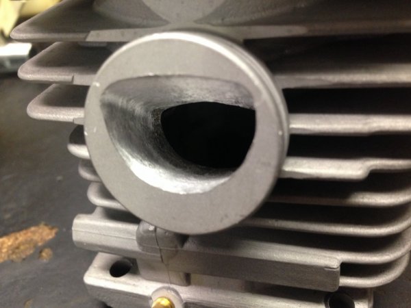

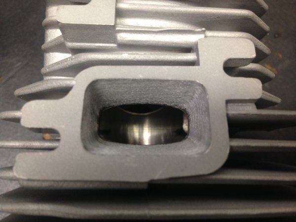

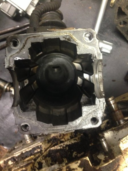

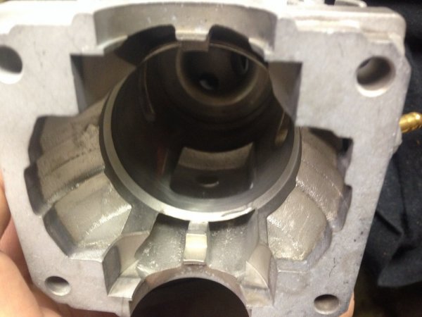

    So here is what a normal cylinder off of a MS290/310/390 looks like right?
    And this is what I got out of the box with the HyWay kit. Little different configuration right? Note the large "button" in the transfer ports. They were also present in the intake and exhaust ports. I ground them off and cleaned up the rough casting inside of the intake/exhaust ports.
    Note that I did not alter the timing or width of the intake/exhaust ports at all. Just cleaned up all the extra material HyWay left in them.
    One other thing, in this particular case, the cylinder had plating sprayed in EVERYWHERE. Cheap grinding burs need not apply.
