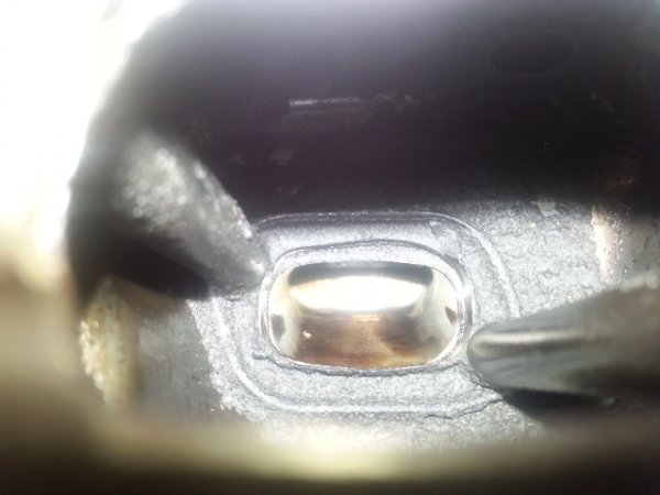

    I've been using Klotz benol for over a year. I do not recommend using it in a chainsaw. Ya I know....yippie another oil thread. Lol.
    3...2....1.....and go!

    32:1 non e90

    Isn't that a little rich?

    Could be with benol. I'm not willing to use a lesser ratio.

    Try original Shaun. It will mix with any fuel you can find and I never had one do that kind of mess. Motul 800 leaves a similar mess if you don't get it hot enough to burn. Any of the castor will like 927 and super techniplate.

    I plan on trying the original or Lucas semi synthetic. I try to buy local when I can and my bike shop only carries benol in klotz brand is why I've been using it.
    A oil debate is not my intensions of this thread. Just showing what benol looks like after a lot of use. Not just a few tanks. I have two saws that are a flipping mess. :D

    No doubt. A lot make a mess cutting firewood. Milling you can run anything since it will be hot enough long enough to burn. Maxima k2 works good too if they have it. A little pricey compared to the others.
