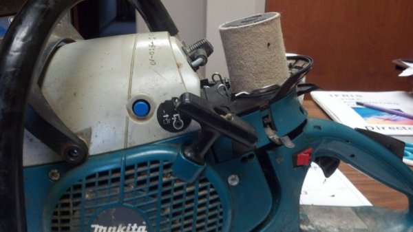

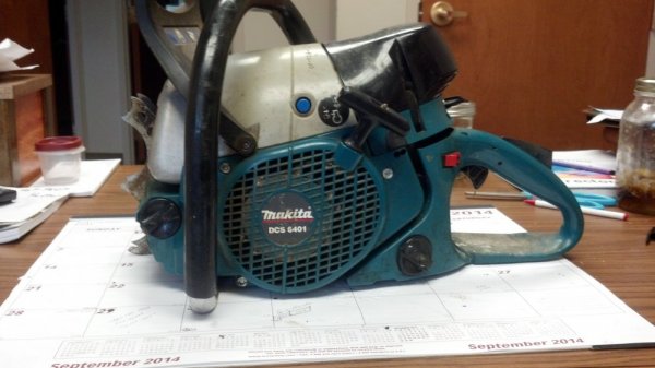

    First for the good, I bought this baby as a Home Depot Rental 6400 in 2010. A little beat up but good compression, started and ran as it should, and had decent power in the 6400 setup. A few months later I put an OEM 7900 topend on it and it was NICE:D. I cut several loads of firewood with her over the next three years as well as using her to cut big logs into sections for chainsaw carving and even as a large blocking saw for carving. IMG_20141006_145419_033.jpg

    Forgot to mention the HD air filter earlier, Its important when installing these things to make sure the rubber boot between the filter and carb is not puckered.
    How do I know this you ask? Stay tuned more to follow soon.

    That rubber boot or whatever it's called is a bad design.

    I think I'm going to see about stuffing a husky filter under there or maybe a k&n.

    There's bound to be something better than stock but not the HD kit that has that boot. I don't like how it doesn't have anything holding it under the cover onto the elbow.

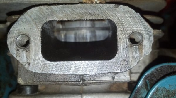

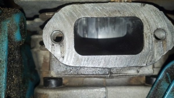

    Sorry for the delay, had to run out for a bit. Now for the ugly, Here is the view through the exhaust port. IMG_20141006_150726_130.jpg IMG_20141006_150650_152.jpg

  10. Murph
    Murph
    Oct 3, 2014
    35
    88
    OUCH! or a mere flesh wound depending on which side of the pond your on.

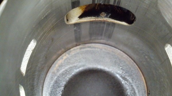

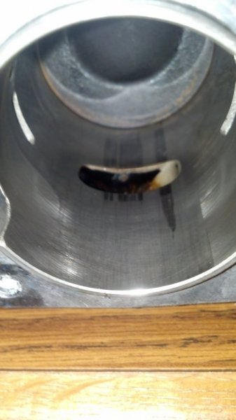

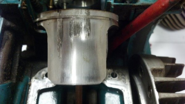

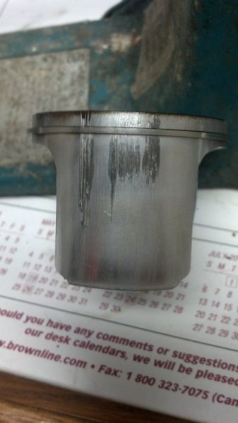

    Here are some shots inside the cylinder sorry for the quality. Looks like just some smear, no scoring that I can see and nothing that will catch a nail. Should clean up ok what do you guys think? IMG_20141006_160226_781.jpg IMG_20141006_160445_587.jpg IMG_20141006_160126_534.jpg

  14. mdavlee
    mdavlee
    Oct 21, 2013
    4,380
    10,478
    Yeah that could have helped the problem. The jug should clean up. A new piston should have you back in business.
    GRIZ, Hedgerow, hokie94 and 1 other person like this.
  15. mdavlee
    mdavlee
    Oct 21, 2013
    4,380
    10,478
    Some sanding with small flapper wheels.
    GRIZ and PullinMyPoulan like this.

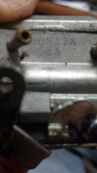

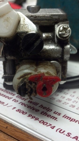

    The H jet on the carb was turned as far rich as the limiter would let it go. This has a zama carb the pic should show the number, are there different bolt on carbs for this saw? IMG_20141006_161810_326.jpg IMG_20141006_161521_309.jpg

  17. mdavlee
    mdavlee
    Oct 21, 2013
    4,380
    10,478
    Trim that limiter with a razor knife. There's a few that go on but not exactly drop in.

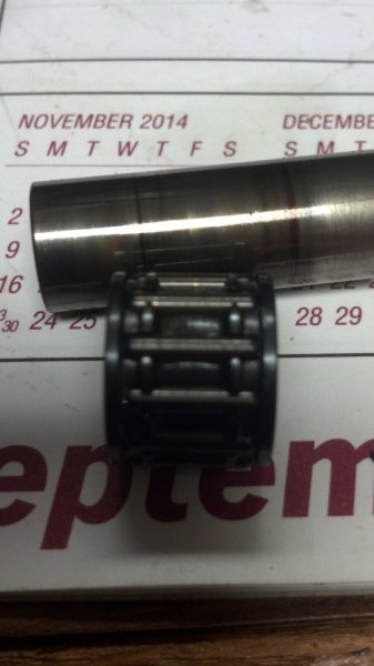

  18. hokie94
    hokie94
    Aug 24, 2014
    89
    244
    southwest va

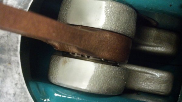

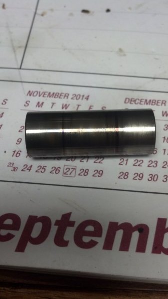

    Just a few more pics and I'll be done. Looks like some discoloration at the end of the rod from the heat.
    GRIZ likes this.
  19. DexterDay
    DexterDay Administrator
    12,411
    31,624
    Northeast Oh
    That wrist pin, rod, and bearing look fine. I've seen much worse.
    That cylinder doesn't look bad at all.
    As Mike said, a new piston and ring and your back in business (and some light sanding on that jug).
    GRIZ, hokie94 and mdavlee like this.
