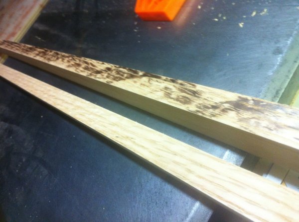

    I haven't been doing much firewood stuff lately - I've been playing around in my workshop mostly since the weather turned really cold. I'm building out my super deluxe radial arm saw station. :D I garbage picked some really nice kitchen cabinets from my neighbors house, and then they ended up replacing more and saved the old ones for me too. So I'm making some countertops for them.
    When I ripped the oak board for the edging, the side against the fence got a lot of burn marks on it - but it's perfectly smooth. The other edge looks like it went through a jointer. I used a Forrest Woodworker II that I've had for about a year. Think it's an indication it needs to be sharpened, or cleaned? There does seem to be more buildup on that side of the blade. Or maybe I'm using it wrong... I adjusted the blade to just barely cut through the wood - should it have been higher for oak?
    It didn't matter anyway, because I've discovered edge jointing at my router station.... :) I planned to take a little off that edge anyway. Still would be nice to know what went wrong though. :confused: :sherlock:

    Ive seen burn marks when the rip fence is not parallel to the blade. I have an older bench saw and I measure the blade to the fence on the infeed and then outfeed of the blade. The blade should also be a bit higher than the thickness of the board unless you are cutting a kerf. I also use a thick steel ruler to measure that distance and not a tape measure that can be flimsy and have a loose tip on it.

    Possibly a bit dull or that the radial arm is not quite square ( constant problem with those) that Forester blade has very little clearance ( very narrow kerf) only about .005 per side so any little bit of runout is magnified. Run out on blades from a quality mfg is about .002 tolerance. They use a decent carbide on those so I am guessing it is a bit dull more than anything. You can clean most of the build up off with a good cleaner/degreaser product and a stiff brush. after it is dry wax it or use a product to prevent build up- several on the market- I do not have a recommendation. use a dial indicator and check the run out with the blade mounted ( not under power). Forrester blades are good, but not a fan of the absolute minimal kerf on those. Note that I am a professional sharpener/ machinist of many years - just stating my back ground.

    Most likely rip fence is out of alignment. It should be about 1/32-1/64" more open at the outfeed end of the table than the infeed. Also, for best results with the Forrest or any other TS blade you should crank the blade up as high as safely possible. If you have a good blade guard, splitter, feather boards and push sticks, you should be able to crank your blade up all the way for all through cuts. Be safe.

    "When I ripped the oak board for the edging, the side against the fence got a lot of burn marks on it - but it's perfectly smooth"
    The side against the fence is always going to be at higher risk of burning because it can get "pinched" between the blade and fence, the other side is free to fall away. A little pinch and you get burn. A little more and you get KICKBACK! Don't ask me how I know... As I said before, make sure your rip fence is adjusted correctly and that you are using proper safety equipment. If all of that is in order, then so be it, sometimes wood burns. A couple of licks with a hand plane will fix that.

    The blade should only be slightly above the material. Make sure the fence is at least parallel to the blade, if not slightly open on the outfeed side.
    That blade shouldn't be dull in a year unless you've got a production shop, so my guess is buildup on the blade. Very easy to clean.
    If you hesitate while running the Oak through, you'll get burns, but that's burned the whole length. Is that pic showing one piece, or more?
    If only one, the burns are indicating that the blade may not be perpendicular to the table. Doesn't take much.
    Have you cleaned the table recently? The fence?
    Get those clean too, then wax 'em.

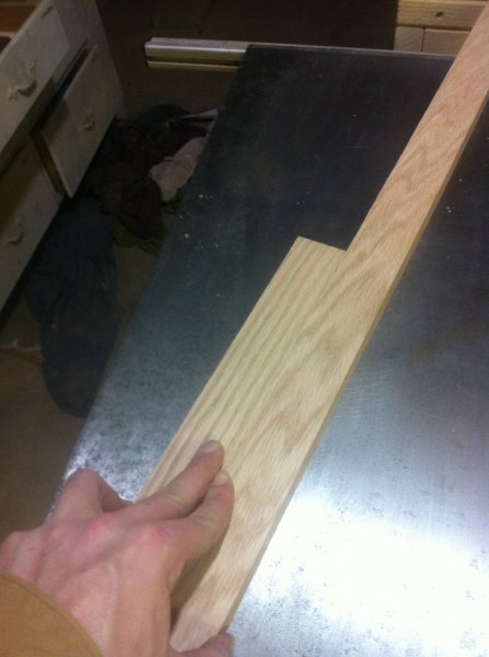

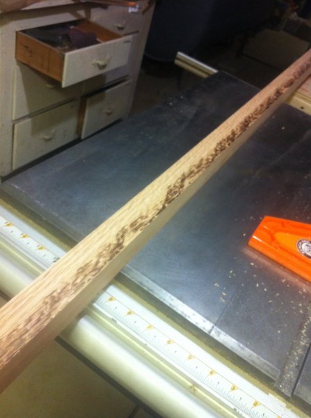

    I thought about the rip fence alignment after I wrote this. I bet that's it. This is a Craftsman contractor style saw - the rip fence is OK, but I usually have to push on the clamping end while locking it down to get it to stay straight to the blade. I should probably check and adjust it again.
    I think I'll stick with the lower blade though - seems to produce the smoothest cuts on my saw that way, and if it's set higher it seems like I get more tear out.
    The 3rd pic is the board from the 1st pic after I ripped it. So there are 2 boards there. I stood them on edge to show the cut faces. The 5th and 6th pics are after I jointed the sawn edges at my router station.
    I think I'm going to try putting the rip fence to the left of the blade after I check it for square. I'd think if sharpness was the issue, there would have been more scratching and tool marks.

    It was the side against the fence that burned. The offcut side had almost zero burning. They both came out nice and smooth though.
    I have another board to rip so ill try putting the fence on the other side of the blade if everything seems square. The fence can easily lock down out of square if you're not careful with this saw, so I'm thinking that was the reason.

    I think you misunderstood me Shawn. In your first pic only 1 half of the THICKNESS of your wood was burnt but in your last pic it does show burning thru out the entire thickness of the wood. I have an older Craftsman TS much like yours that when I was in the trades I hauled from job to job in the back of my work truck. One thing you cannot do is rely on is the measurements on the fence or the tilt angle of the saw. Measure, measure measure. I'm thinking you have several things going on here. Blade choice is 1, dullness of blade, rate of feed of stock into the blade, pinch due to fence not parallel to blade or blade not square with the table top. Another thing I noticed in your original pics was the feather board on the TS. Is that in the right spot? Also, how long has the oak been in your shop to get acclimated to the temps and humidity? I know, more questions than answers but....
    One thing you can try to narrow down the problem is to rip a piece down to within a quarter of an inch of your final width and then readjust your fence to the desired width and run it thru again at a faster rate of speed.
