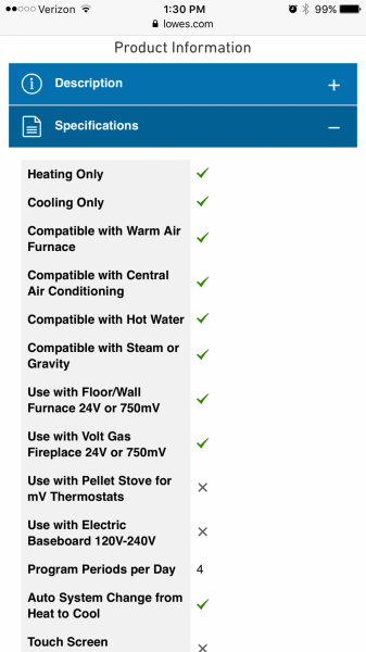

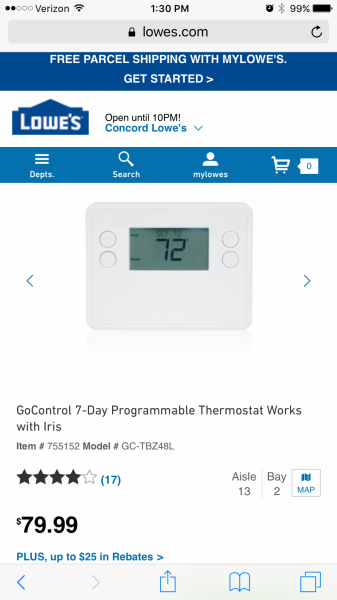

    Which Iris? The one I have seen are not millivolt.

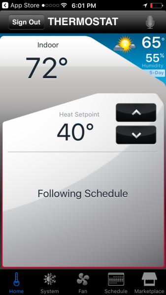

    therm.png Worked like a charm. :)
