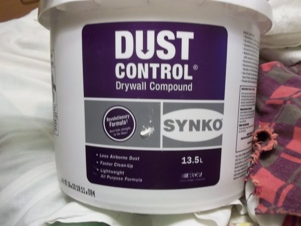

    Thanks for all the suggestions as well. I used the Swiffer starter kit that I bought by mistake to clean the drywall that campinspecter mudded over the last week. Yesterday we sanded, cleaned, primed and two colour coats on the kitchen area and everything up to prime on the bathroom ceiling. This new drywall mud that campinspecter used dropped like snow while sanding instead of exploding into every nook and cranny in the area. Much better than the old stuff we have used previously.

    What kind of mud did he use? It might have been mentioned in a previous comment, but I'm not even supposed to be on the computer for a couple of days, so if you could please indulge me?

    Synko Dust Control Drywall Compound. It worked really well. I hope you can get it down there.

    I used a similar type of mud and had the same results. The only problem I have with it is that it is very very soft and fluffy so I had a hard time working with it on bigger joints and when it dries it's very easy to sand down to much and have to put on another coat.

    Yup. The newer lightweight stuff is a little different than the old all-purpose. But I like it, I had to thin it out a bit before it worked nice but once I had it down to Cool-Whip, we were off to the races.
