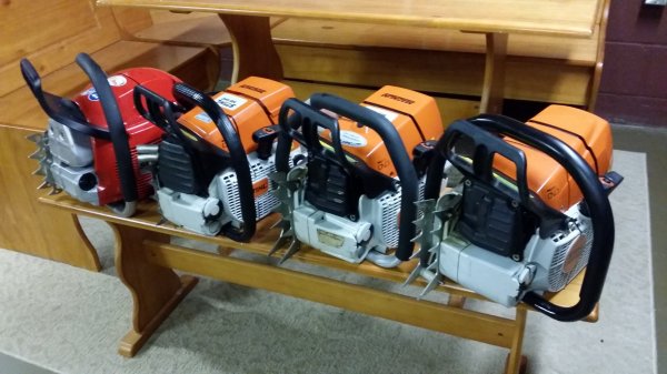

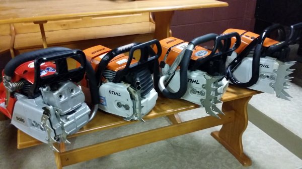

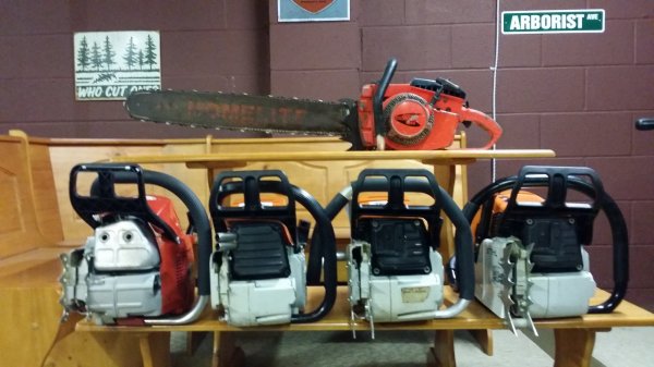

    Had a little time today so I decided to run 4 saws in the same Cant with the same chain.
    The four saws I ran were a...
    Stock (double barrel muff mod) MS 440
    Stock (tri-port muff mod) MS 461
    Stock Solo 681 (no muff mod)
    Mastermind ported (tri-port muff mod) MS 460

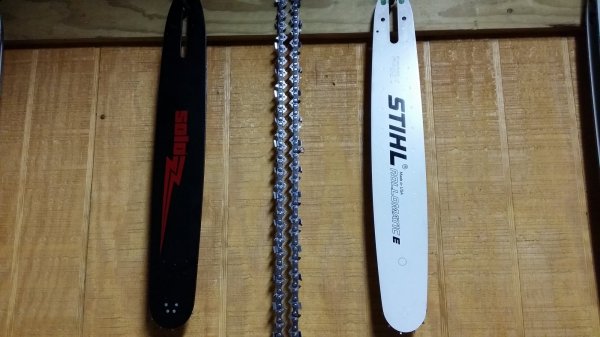

    Solo ran a Solo branded bar and the Stihls ran a standard E series bar. Both sprocket tip..
    All were ran with the same chain.
    Stihl RSL with gullets cleaned out. (Courtesy of a member here)
    Pics of the saws..
    20141123_171750.jpg 20141123_171706.jpg 20141123_171902.jpg 20141123_171950.jpg
