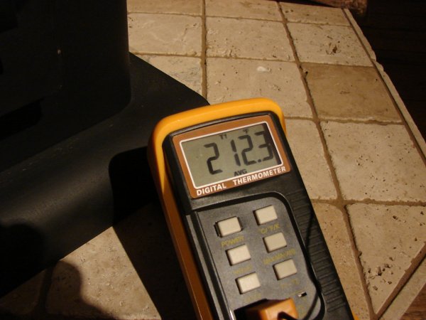

    Temp Above Door (max) - 413
    Convection Air Temp (avg) - 212

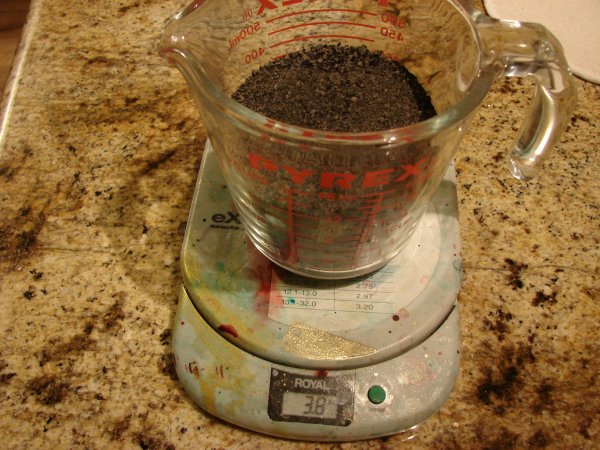

    Ash Volume - 12 ounces (from 10 pounds of pellets)
    Ash Weight - 3.8 ounces (from 10 pounds of pellets)
    Ash Percentage - 2.37% :eek:

    Picked up two bags of these at Tractor Supply and was looking forward to testing them after reading the positive specs on the bag. The first bag I burned was mixed with another brand (1/2 bag) already in the hopper but, after burning that bag and cleaning the stove I decided to only burn 10 pounds for the test as a 40 pound bag left the stove full of ash and the glass almost opaque. These made good heat on level 4 but because of the high ash content the stove would need a thorough cleaning every day to maintain that heat output.
    Not recommended at any price unless you enjoy cleaning your stove daily.
