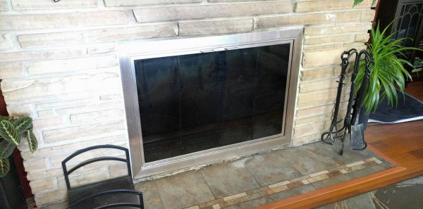

    Here is a photo of the fireplace doors that I plan to remove and replace with a wood burning insert

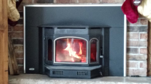

    heres a picture of the 4100i[​IMG]

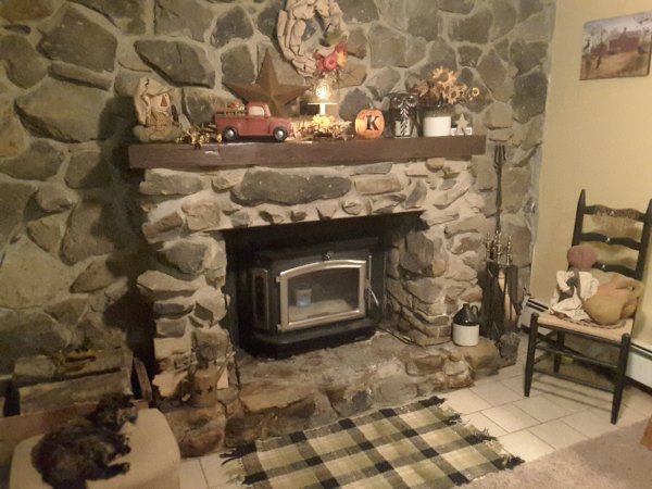

    Here is another one that will fit, 20171007_212823.jpg Buck 91, getting ready to start our 4th winter with this stove.
