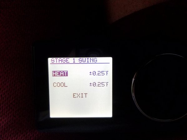

    Is there a swing setting on it?

    27,032
    Denver, NC
    Yes. Interestingly enough, the installation instructions don't even mention it, but it's there.

    Here's a pic of the swing screen, and I attached a copy of the Install instructions for you to browse.
