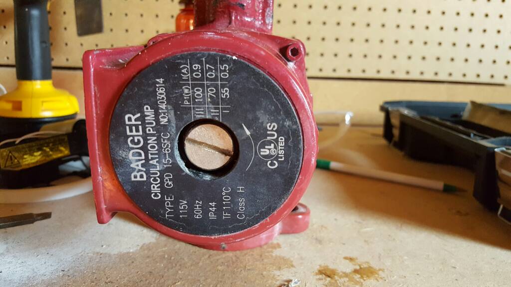

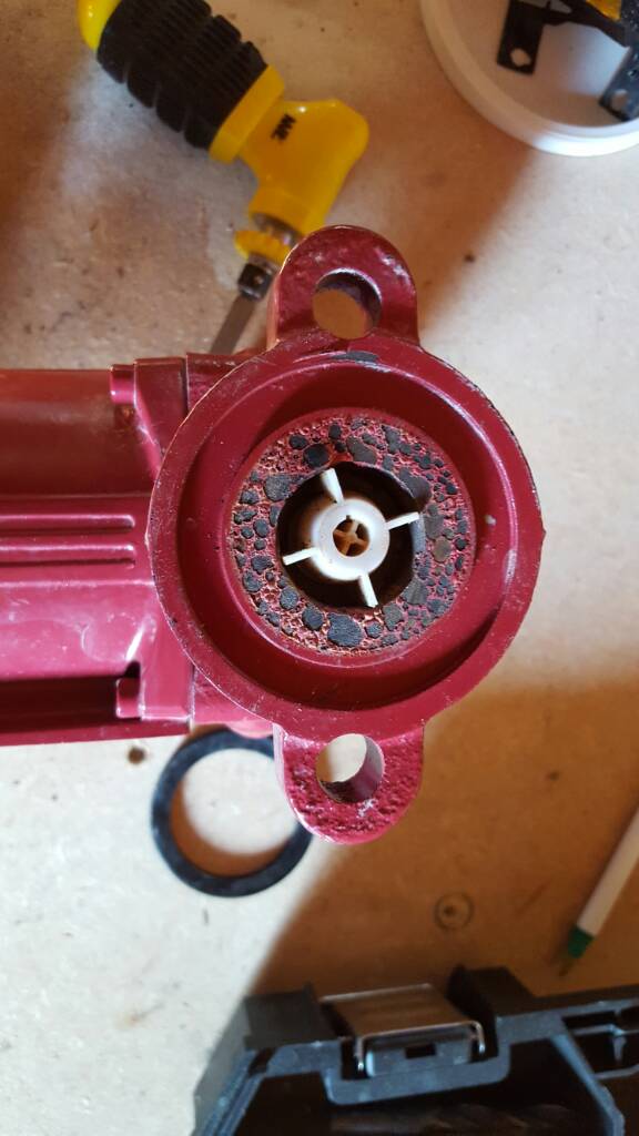

    I had this pump on the first year burning and it kept leaking near flanges. I don't know much about pumps, dealer sold it to me with boiler. I took it off today and noticed the impeller was stuck from corrosion. Looking for a new pump, willl a taco 007 be enough, cast iron with bronze cartridge? 100ft run one way. Thanks!

  2. Hydro Farmer
    Hydro Farmer
    173
    459
    Hinckley, MN
    No idea. There is all the math involved. I would just call Taco and talk to an engineer. They were cool and gave me the time of day. I ended up going with a different mfgr. But they were cool enough to try and work with me. As the old saying goes, "it never hurts to ask." Call them.

  3. Horkn
    26,985
    150,600
    A taco 007 is a great pump. Yeah, you can get bigger taco pumps, but the 07s work great.
    100 ft is nothing for them.
  4. tractorman44
    tractorman44
    Feb 12, 2016
    286
    1,531
    Festus, Missouri
    All pump suppliers that I've dealt with over the years have conversion charts that pretty much cross reference all competitors pumps. When you're on the phone with them, provide your model and brand and they should be able to provide you a comparable replacement, whether its an 007 or not. Any competent counter man will be able to come up with the answer quickly.

  5. TurboDiesel
    16,048
    95,627
    The corrosion is probably the bigger problem.
    Those Taco pumps last. I would drain the system and flush it and refill with added corrosion inhibitor.
    Maybe even use distilled water if you water is hard.

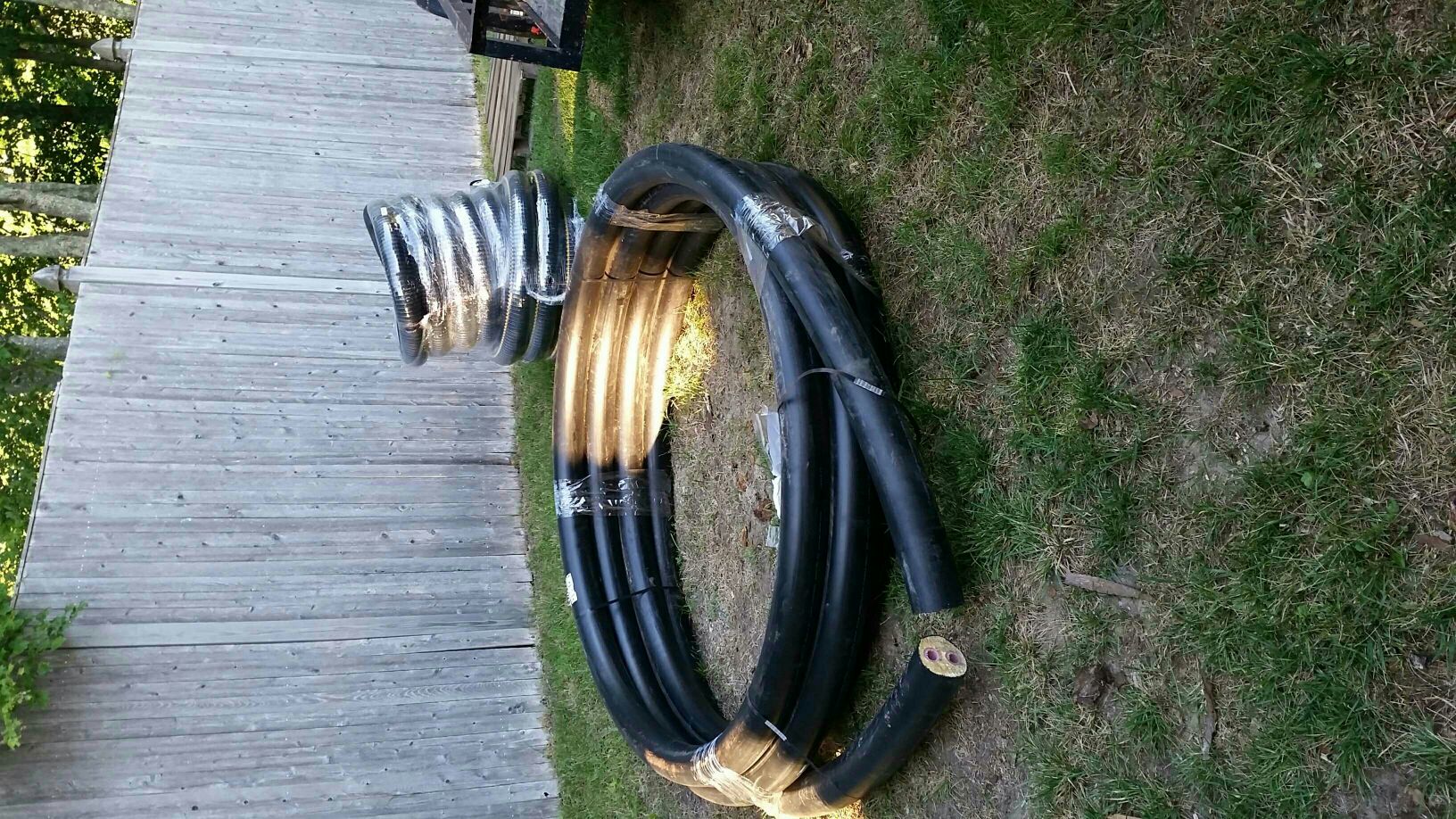

    I plan on having 2 sets of pipe from boiler. 1 for house and 1 for pool. I don't plan on running the pool all year. Can I drain this loop?

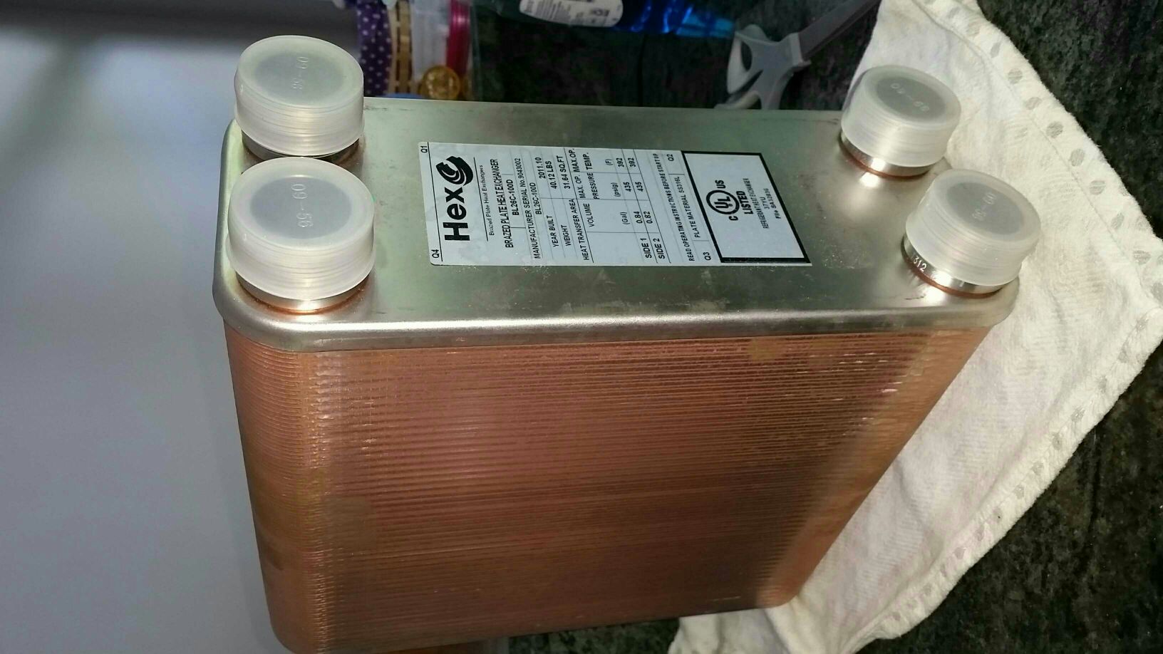

  13. LongPondPaperBoy
    LongPondPaperBoy
    Nov 20, 2014
    118
    103
    Lakeville
    [​IMG] look what just arrived

  14. yooperdave
    32,035
    194,024
    i have never used that type of exchanger, but I here that they are phenomenal! Good score!

  17. LongPondPaperBoy
    LongPondPaperBoy
    Nov 20, 2014
    118
    103
    Lakeville
    [​IMG] got my pipe in. Got 2 different brands 1 will be for main house other for pool
