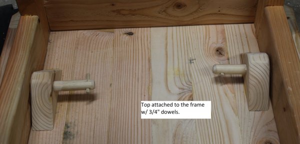

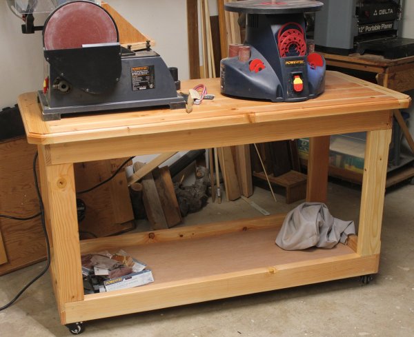

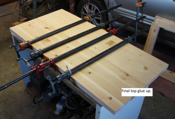

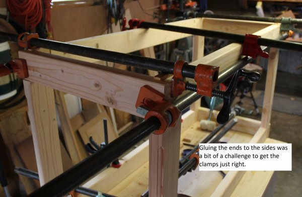

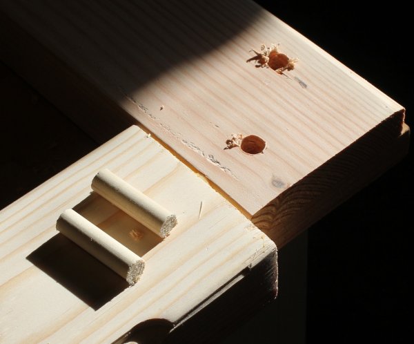

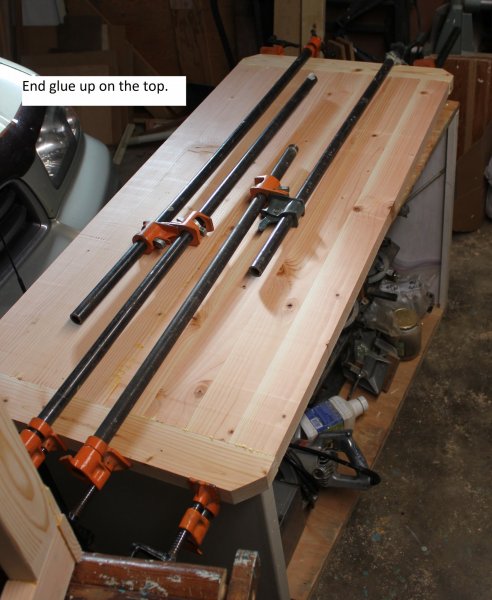

    As I started putting by basement shop together, I, of course, bought the toys before
    I had a real place to put them. Example, my belt/disk sander and oscillating
    spindle sander. I revived an old desk for temporary use.
    So, finally in semi retirement, I have time to do it right. Inspired by the old oak
    fire wood I got w/the pinned mortise/tenion joints, I decided to build this
    table w/out any metal. No nails or screws.....other than the ones to mount the wheels.
    Edge joints are doweled and the frame joints are pinned lap joints.
    Still needs a drawer for sander stuff and another shelf on the bottom for belts.
