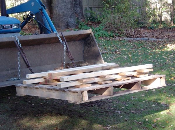

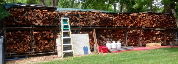

    I've been using pallets like this for 10 years or so.
    The first pallet racks I made were built so I could take them apart and break them down flat as I used the wood. I still have the first ones I built this way and they work well but are too much work and cost to keep making.
    Can't beat it.
    It's my pallets free. The oak pallets are used for racks and I take crummy oak ones apart for boards for uprights and sides. I Put old ones or pine pallets under the wood pallets as sacrificial ones to keep the wood pallets off the ground.
    The first pics are the old pallet racks which are now 10 years old and still in use

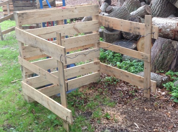

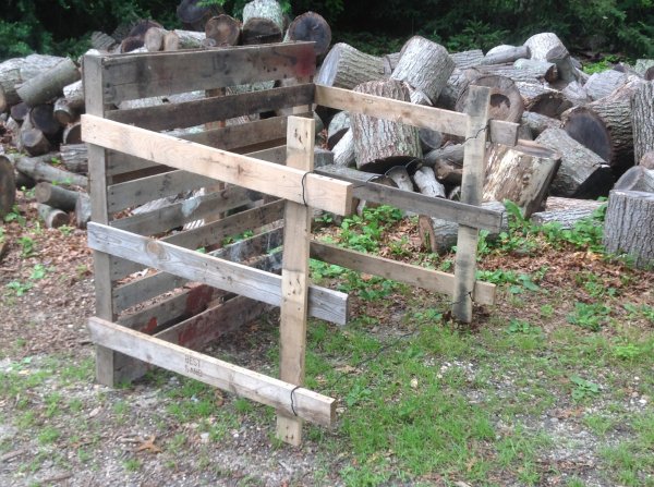

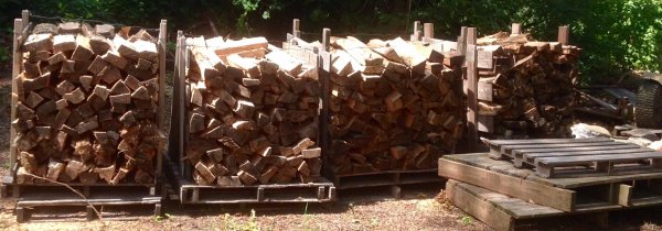

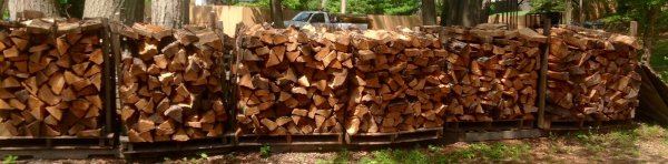

    These pics are how I'm making the pallet racks now
    All wood is from pallets taken apart
    The empty ones are on their side so I can move them with a hand truck
    You have to look close but there are two strands of wire across each of the uprights.
    Wire is unwoven from black chain link fence. It holds up well and keeps sides from spreading when I'm moving with tractor.

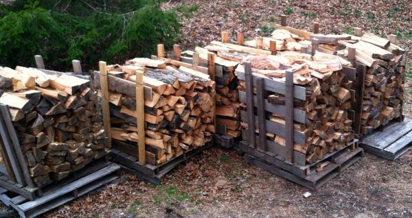

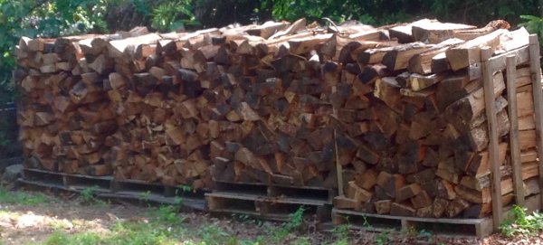

    I'm a hoarder, I admit it!
    And I find I'm a bit anal about how I split wood by species
    I have mostly oak the oldest is from hurricane Sandy 5 years old. Lots and lots of Oak.
    All split and stacked together.
    Just finished splitting all the cherry I've been saving

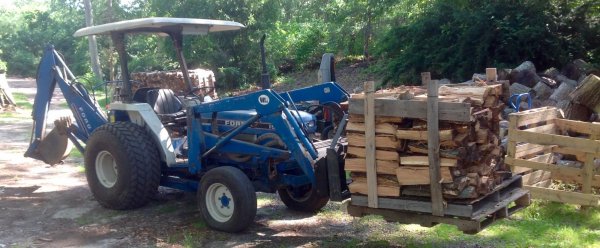

    FatBoy85 I only use hardwood pallets for racks. The old way I did it I did cut a slot and added an extra 2x4 to lock pocket 2x4 in but this took too much work for a lot of pallets. It might work for you. If you look closely at the first set of pics you can see how it was done. Your racks look strong the way you did them.you could try cutting the pockets on the right and left sides and slide in the 2x4 upright and screw it or add the extra sleeper in the bottom.
    billb3 I have a Ford 1920 and can lift around 1100 lbs or so. A really full red oak pallet I can only lift up 10 inches or so
    If you can lift pallets cut some in half add sides and there you go. I'm sure you could lift half a pallet. Don't forget wire across top to keep it from spreading out.
    Experiment
    If you have forks use em, they're like your private work crew.
    With oak pallets I use epoxy deck screws or galvanized ringshank nails from a nail gun and both hold great!
    With a softwood pallet ringshank nails pull right out but screws hold well

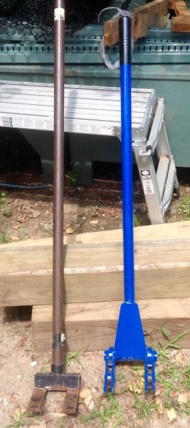

    I have 2 tools for dismantling pallets the blue one is very heavy duty. Takes 5 min to take apart a pallet.
    Once pallets are dismantled just takes a few minutes to make pallet rack.
    The pallet my tractor is lifting is wet red oak with a sacrificial pallet under it

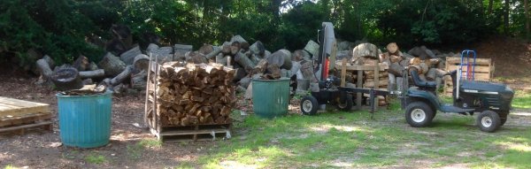

    Some more pics top 2 are all ok just split a few weeks ago. Bottom left is maple split for my daughter. Bottom right is splitting area today with wet red and white oak. Green barrels are for bark and junk thrown in as I'm splitting. The pallet on the far side of the splitter was extra large and I could only lift it enough to get sacrificial pallet under it. And that was revvin the engine too! The old craftsman mowerhas deck removed and is dedicated to towing splitter and dragging a roll of chain link around to smooth ground surface

    mikeward, does your blue pallet puller have the pivoting feet?
    I like it- keeps from splitting boards/slats.....
    Backwoods Savage, Horkn and FatBoy85 like this.
  10. mikeward
    mikeward
    260
    1,707
    Long Island, New York
    yes it does and is very heavy duty
    but
    it doesn't fit between top boards on most pallets so you have to break one board in the center to make room

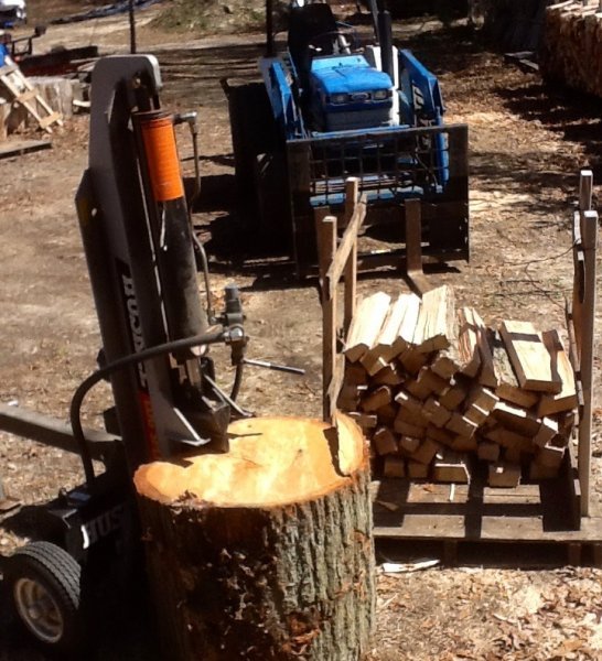

    Hey billb3 if you cut a pallet in half and put sides on it , I bet you could pick it up
    You could call it a face pallet
    When I split I'm sitting down and turn left or right and place split right on pallet.
    When done I get tractor and move pallet to sunny storage area
    Then repeat. I like that there is no big pile of splits to be moved and restacked.
    The restocking of the big pile was the worst as far as I'm concerned.
    That's the reason I started with pallets. Got the idea when I was at a stone quarry and looked at how they were stacking and moving bluestone around
    Never looked back!!

    billb3 the splits will stay on pallet if you have a wire or something like it across the top. The wood tends to settle down between the uprights nice and snug as long as you have something across the top. I'd be interested in hearing if the half pallet works for you.
