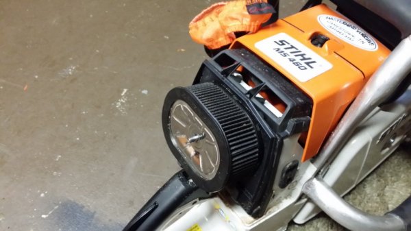

    I bought these going into Winter for both the 441 and the 460
    With the way the filtration works on the 441, it really doesn't need one. But the old MS 460 really benefits from one of these.
    Actually, any saw running an HD2 set up could benefit from these. The pleats on the HD2 get plugged in no time when under heavy use.
    I forgot all about mine until I went to clean and service my saws yesterday. Figured I would let the masses see it and decide for themselves whether they would benefit from it.
    They also make a recoil cover (intake) to stop chips (acts as a pre filter) and snow in the winter time.
    They are relatively cheap ($6.95) and come in any color to match. They only make the covers for Stihl (044/440 up to 088/880) and some Echo models.
    (This is not my saw. I think you have to attach velcro or something to that effect for this to be mounted)
    This is my 460 with orange filter installed.
    (I do not work for, affiliate with, or get any kick back from this ;))
    This is me trying to help a fellow member who runs an HD set up saw.. :thumbs:

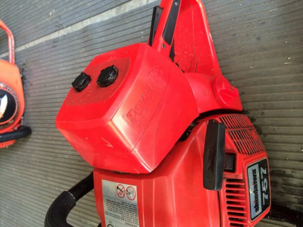

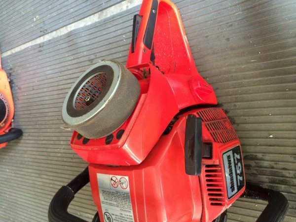

    The filter set up on my Shindaiwa 757. The main filter is an automotive style with a foam prefilter. If you can find them, the two of them will set you back about $42.

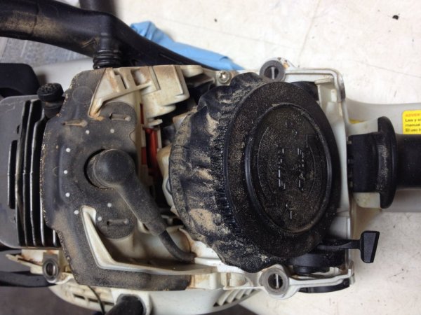

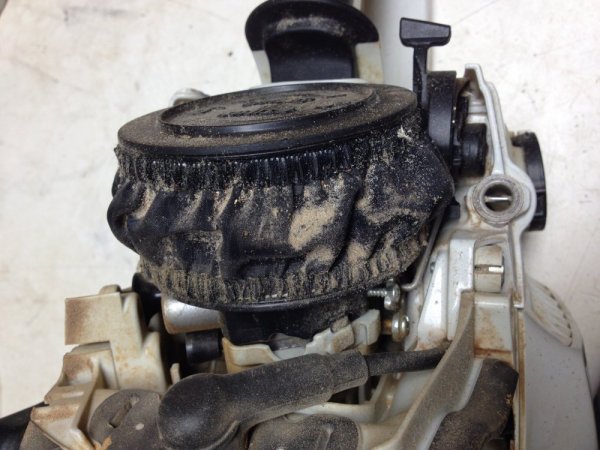

    Hey MM, regarding air filter clogging on the 261...
    Not long ago I fell, limbed, bucked, and flush cut a freshly dead spruce tree in my yard. Not a big tree, I'd say about 25' tall and 12"-15" DBH. It just occurred to me that I hadn't gotten around to cleaning my saw yet. Here's what it looks like having done that work in primarily warm/dry weather. The saw was spotless before doing that work, so this is just a single tree and less than a tank of gas. This obviously looks worse on the outerwear than it would have on the pleated filter, but it's still a good bit of fines. Does yours stay cleaner than this?

    I agree. Any fines/dust is not good. These prohibit the filter from getting almost no fines in them. Because over time, it will plug itself.

    That may be more debris than I had in the saw from a whole winter of cutting....... But I cut a lot of silver maple this winter with razor sharp chain so that may make a bit of difference in the amount of dust generated.

    My 362 wouldn't get that much dust after 5 tanks. I've tapped out the filter a couple times since I've had it and got almost nothing out each time.

    That's crazy. Again, this was dead evergreen, but was certainly cut with a fresh-off-the-grinder RS Stihl chain. I cut a lot of ash & hickory over the winter and although I would cut for the majority of a day I still had every bit that much dust/debris when I got home of an evening. Started every day with a freshly sharp (either grinder or touched up with a file) chain too. Hard telling...
