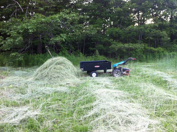

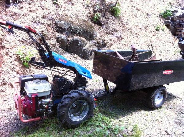

    Great question! I bent the original tongue on the trailer by trying to PUSH a heaping load of wet compost. image.jpg
    After that, I replaced the tongue with a length of 2" square stock and put a sturdier latch on to keep it from dumping accidentally.
    In this picture, I had already moved the pivot point of the dump to the center of the trailer so it balanced enough to be dumpable by hand.
    As for pulling, my BCS tractors will pull like crazy and are never short on power.

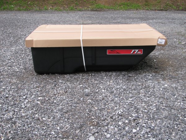

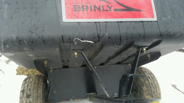

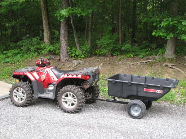

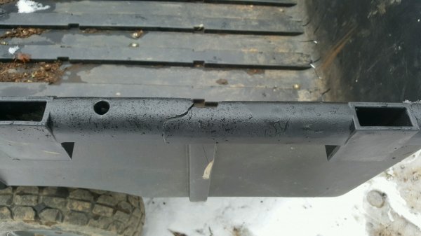

    The cart or the broken plastic tub? IMG_0614.JPG IMG_0618.JPG untitled (1).jpg untitled.jpg
