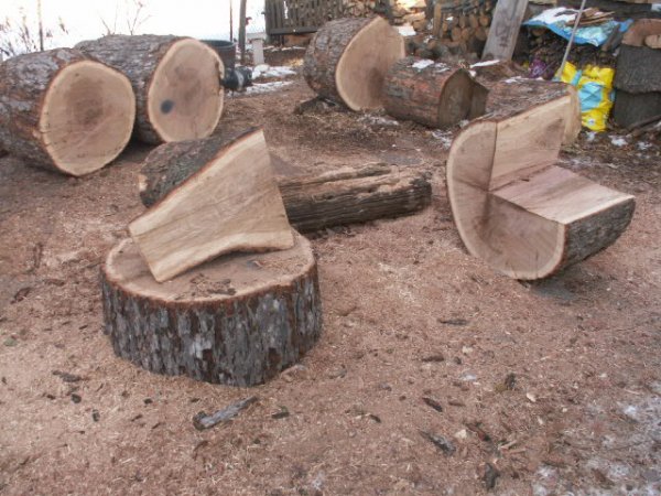

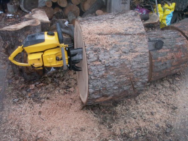

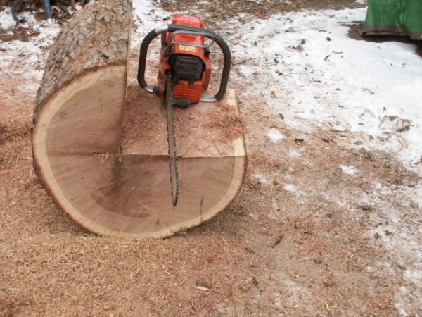

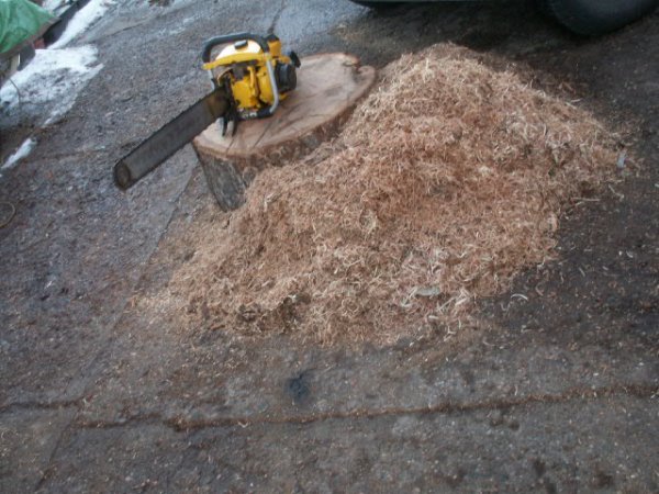

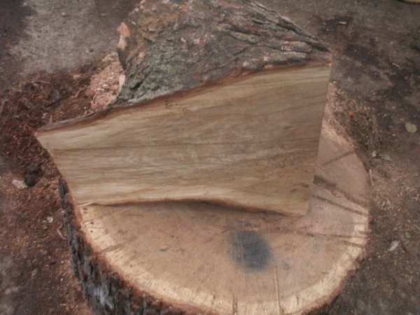

    How's it work for me? Pretty good I'd say....;) :D
    I do this when needing to break down large/gnarly rounds/stumps/crotches that are near impossible to split.Dont waste much time killing my back with the sledge/wedges or the maul.Stuff that the X27 just bounces off of.
    But mainly its roughing out shorter blocks/slabs for future woodworking,bowl blanks for the wood lathe that aren't worth setting up the Alaskan mill for.
    Plus its a blast to be knee deep in shavings in a matter of seconds,much more fun than standing there pushing a lever back & forth.:saw: The shavings are great fire starter - I keep 2-3 big bags full in the shed,a handful every morning does the trick.And all the rest is used for mulch & filling in low spots around the processing area.Great to walk on,very kind to your feet.
