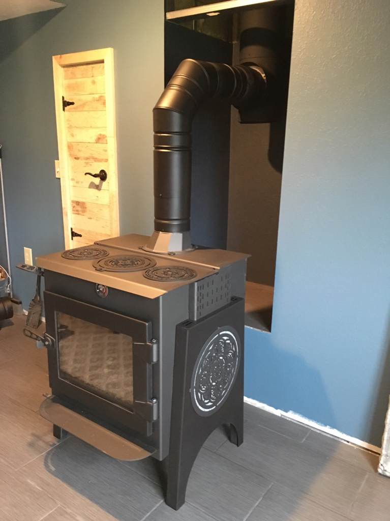

    Nice install. I especially like those long floor tiles BTW.
    Brian

    My Woodstock Soapstone Ideal Steel will leak both smoke and flyash if the door is left open during startup or whenever the stove is running. The door opening measures 17" X 10" to the smoke skirt and the actual opening in the front of the stove is 17" X 12". I have 32 feet of brand new, clean DuraVent double walled Stainless Steel chimney with an outstanding draft and no other appliances on that chimney but that stove. The basic problem is that the smoke pipe, being just under 30 Sq. In. will not overcome all the smoke the wood is giving off plus all the air that flows into the stove through the door opening. Most of it DOES flow up the chimney to be sure but some flows out of the stove at the upper lip of the door opening. If I leave the door open long enough, it will trip the smoke detector in the same room as the wood stove, although it does not trigger the smoke detector if opened, loaded quickly and then quickly closed. The basic problem is that it is easier for some of the smoke, especially that generated toward the front of the stove, to simply flow into the room than to flow across the inside of the stove and join the other air / smoke flowing up the chimney. Opening the door requires that the 6" diameter chimeny pull hard enough to maintain a negative pressure across at least 170 Sq. In. area, which it cannot do.
    Putting a draft inducer on the chimney eliminated the problem; I can leave the door fully open while starting a fire or once a fire is well established. In fact, I can remove the door from the stove, take it outside and clean the glass, and then re-install the stove all while the stove is fully engaged and running..... but only with the draft inducer in place. Also, with the draft inducer on I can fully open the door, reach into the stove with a hoe and push and pull the ashes all around until they all drop through the grate without getting any flyash in the room, and that too was impossible without the draft inducer.
    Several people have complained about this issue with various stoves and I merely presented a possible solution to their problem; I only mention this because it worked for me and has entirely removed the problem of the stove leaking material (smoke, smell and ash) into the room. I am certainly not suggesting everyone or even any single person buy or install a draft inducer based on my experience or remarks, I am simply sharing some small knowledge and experience I have gained with others to use as they see fit to do so.
