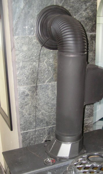

    The draft inducer is the 'blob' in the middle of the vertical smoke pipe. It is basically just a squirrel cage type of blower with about 3" of the blade sticking into the smoke pipe. It works by accelerating the air (and smoke) in the smoke pipe upward. This design leaves the majority of the smoke pipe open and unrestricted for normal use when the blower is not turned on.
    Before someone asks, the 'wire' going to the top of the smoke pipe bottom is a thermocouple. There is also a thermocouple on the stove top, the magnetic thermometer is only there to hold the end of the thermocouple in place.
