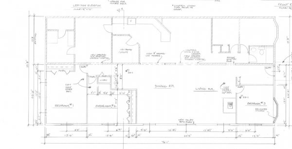

    The original spot for the stove is gone (was in 12x12 mudroom on side of house) so will be a new chimney install. Mobile home is 16x76 and 5 years old so has high insulation already and addition will be the same. Both sides have vaulted ceiling with several open area's between the two. It heated the house ok, had to keep the stove going steady when it was that cold to keep 70' in the house. Burning aspen only. Alternate source of heat is 2 forced air electric furnaces.
    Want a good stove, doesn't have to be fancy looking - a glass window door would be nice. Has to be Mobile Home Approved. Biggest want would be long north-south loading so I dont have to cut 12" pieces. Old one was non cat, but willing to try cat. Would like to be 6k or less including chimney.
    I uploaded a blue print of house, bottom is the addition and stove will be in the living room on that side. house.jpg
