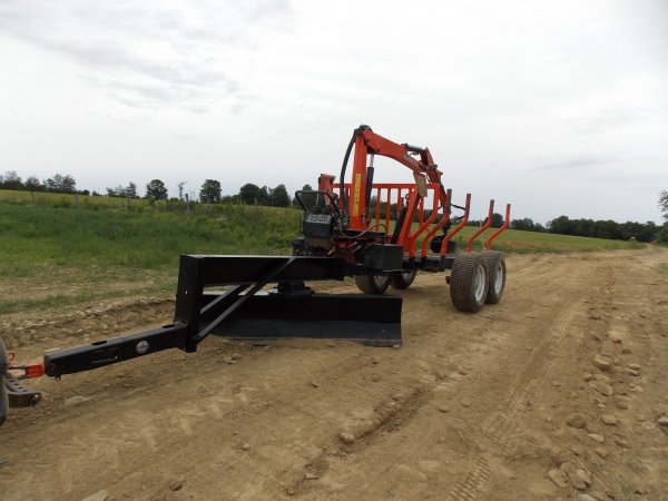

    At first glance a person would think that with a 3 point hitch grader attached to a tractor would get a lot done. That is not the case however because they do not really grade; when the tractor goes into a hole, the grader blade digs too deep, and when it goes over a bump it lifts the grader off the ground; all this leaves a very wavy surface. NO GOOD! If a person is constantly adjusting the 3 point hitch lever it can somewhat be blended out, but not by a lot.
    This summer I got a grant from the USDA-NRCS to extend a logging road up a 9% grade and really needed the road to be smooth and properly crowned.
    To get that, I took my grader off its 3 point hitch, mounted it to an I-Beam with a gooseneck, then inserted it between the bolt on hitch of my Wallenstein Log Trailer. The Wallenstein Log Trailer works well because it is already pretty long, but mostly because its two walking beam axles allowing the blade to remain flat to the ground even if the wheels hit a rock or something. It works exceedingly well, taking only a pass or two to really get the roadway flat. It kind of is a pain to bolt it all up, but overall is worth it for the work that it does.

    Wow! You sure are talented. I have a box scraper for my tractor and find it's easier to move our clay soil when it's wet. The box scraper doesn't seem to bounce like you describe, I've experienced that with a your rake and it was annoying.

    LT - First of all: Nice job! The floating 3 point hitch is not great for that kind of work but your solution is right on the money!

    Sweet setup! :dex::thumbs: Put a seat on the rig and have someone you trust run the blade while you drive at a snails pace.:whistle:

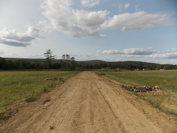

    Here are a few before and after photos. This one is of the roadway looking downhill...

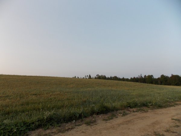

    This is the before and after photos for the field...

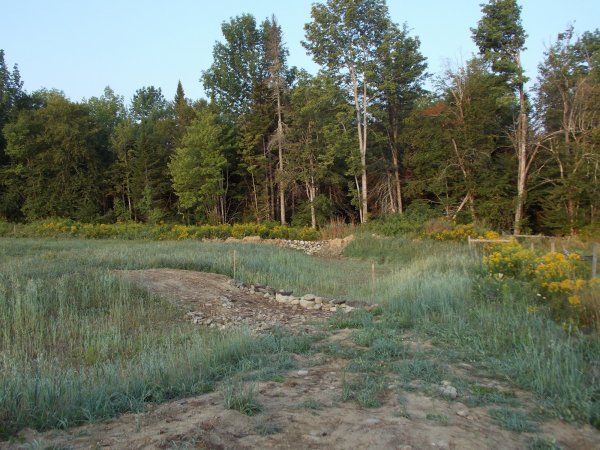

    And finally this is of the swale work that was done. It included a rock ford so that I could get into this field. (The rock ford they did not pay for though).
