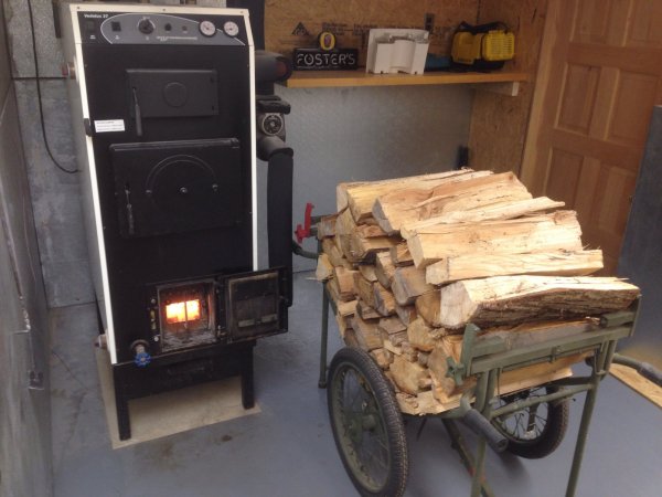

    garns have the option to exhaust like that. they are indoor open systems that shine for use with low temp distribution. they extract so much heat out of the fire that you can hold your hand in that barrel.
    i put my indoor closed system with thermal storage in the barn. Vedolux 37 install | Firewood Hoarders Club wouldnt change much at all . i like that i dont have a flame in my house. warm workshop out of earshot from the wife. can bring a winters worth of wood under cover. extended times between fires due to storage. wouldnt have it any other way.
    fuelrod, Horkn and Canadian border VT like this.

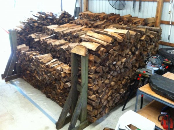

  19. coal reaper
    coal reaper
    1,138
    2,968
    Nj
    pictured is a year supply of properly seasoned wood for my 2500sqft cathedral ceiling house on top of a mountain with northwestern wind exposure. i resupply end of september. i lose that floor space for half of the year, the cold half.
    my barn itself is not insulated. my 10x30' "boiler shop" is. stays 65-70 all year. besides the single wall pipe, i can touch all surfaces of the boiler when it is burning. not too too much residual heat coming off of the thing, but i do catch it all. additionally, i have about 15' of uninsulated return pex line that i let leak into that room. the water in that line can be anywhere from 120-160*. when its colder out, house demands more, return water temp is higher, boiler shop stays same temp. nice.
    Deer Meadow Farm likes this.
