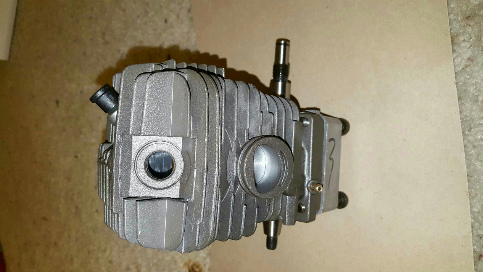

    Id wait to put the Caber rings in before I assemble it. Those 1127 are a pain to get at the jug. Not just a quick 10 min job.
    Allen Lee likes this.
  2. MasterMech
    9,538
    25,551
    Greenville County SC
    I wouldn't run those wrist pin clips. They are just waiting to ruin that motor IMO. OEM clips are cheap enough.
    Thank you for the pics!
  3. Nixon
    Nixon
    669
    3,009
    West Sunbury,Pa .
    What Brian said ! Ditch the wristpin retainers . Other than that , looks like you are going to have a decent runner ! Enjoy !!

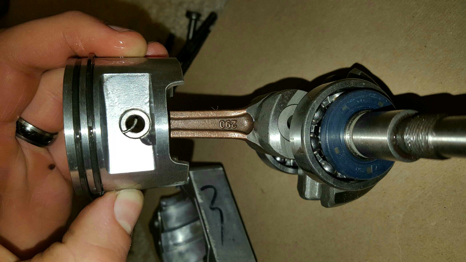

  4. Allen Lee
    Allen Lee
    Nov 28, 2015
    102
    308
    California
    Is there a good place to get these on ebay? I can't seem to find them. Thank you all for your input! This is my first chainsaw rebuild so I appreciate you guys walking me through it! The only thing is I don't have a wrist pin clip installer and don't want to ruin them while trying to put them in. I wonder if the stihl dealer down the road would pop em in real quick for me?
    clemsonfor likes this.
  5. MasterMech
    9,538
    25,551
    If you have a dealer down the road, I would buy them there if he has 'em. Buy a couple extras if it's your first time. ;) They can be installed carefully just by pressing them into place with a small flat screwdriver. The thing to avoid is squeezing them into place with with a pair of pliers.
  6. clemsonfor
    clemsonfor
    15,968
    37,265
    Greenwood county SC
    Yea you can install them with a screw driver and be care full.
    The clips are probably just as cheap at a dealer
    Allen Lee and Barcroftb like this.
  7. Barcroftb
    Barcroftb
    Sep 30, 2015
    2,884
    16,455
    The Mitten
    X2 on the screw driver. I have had good luck starting the one end then just ease the rest in a little at a time as you work your way around the opening.
    If you start to think about picking up a pair of needle nose pliers, stop and slap yourself. Then proceed with the screw driver. :D
    If you get impatient think of all the many years of service the saw will give you if you take your time and do the job right.
    Allen Lee, Nixon and clemsonfor like this.
  8. cnice_37
    cnice_37
    3,205
    14,195
    For wrist pins I get it started and then keep my thumb over it while working it in so if it kicks back its not getting lost forever.
    Allen Lee, Oldman47 and Barcroftb like this.
  9. Barcroftb
    Barcroftb
    Sep 30, 2015
    2,884
    16,455
    The Mitten
    Man I left that part out on purpose! Way to rob the poor guy of valuable life lessons!:thumbs:

    I filed a groove in an old screwdriver and work it in as described above. Ive taken to taping my thumb with electrical tape to prevent the driver from finding its way deep into my flesh lol. It sorta works!

    the best method to put circlips is to use a tube about 10cm long and little smaler than the piston groove hole , for example if you have 10mm c-clip use a tube 9 mm
    then you just put the clip inside the tube next the tube to piston and with something a hair smaller of tube diameter ( 9mm ) you push the c-clip to the piston .
    works perfect everytime

    I got my Stihl wrist pin circlips. Any other tips on installing them?[​IMG]
    pantelis likes this.
  19. clemsonfor
    clemsonfor
    15,968
    37,265
    Greenwood county SC
    Start from one end and work the other with a screwdriver. Keep a hand over if possible
    Allen Lee and pantelis like this.
  20. pantelis
    pantelis
    Apr 21, 2015
    861
    1,384
    Europe
    The mahle video show how to install them with a screwdriver
