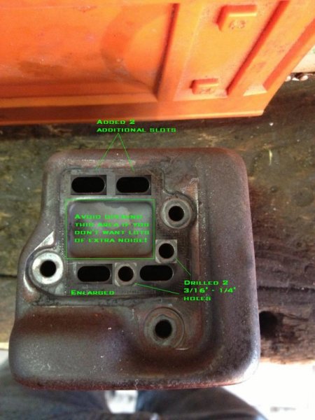

    Basically mirror the slots that are under the depressed area of the muffler to the top side of the depression, a couple 3/16" holes where you can, do not open anything in the depressed area unless you are ready for a lot more noise. Open the deflector as much as practical and call it good. That should wake a 290 up a bit. Then sell it. Seriously, they bring good cash and will make a Homelite/Poulan/etc. owner very happy. Your 034 more than covers the duties a 290 would.

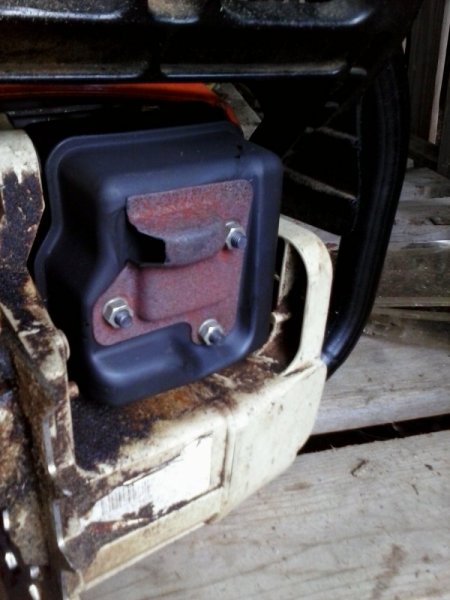

    Something like this:
    You could take even more off the deflector.
