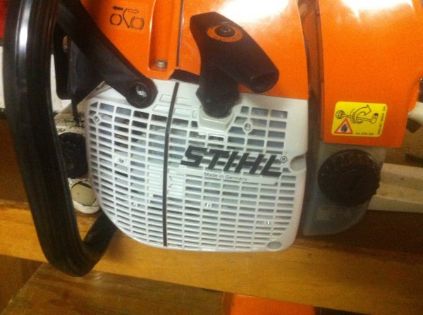

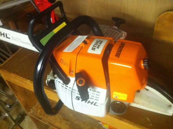

    Beautiful - followed your instructions, and she fired on the first pull. :thumbs:
    So on the brighter side, she's looking pretty nice now with a whole new set of covers!
    Before: :(
    After: :)
